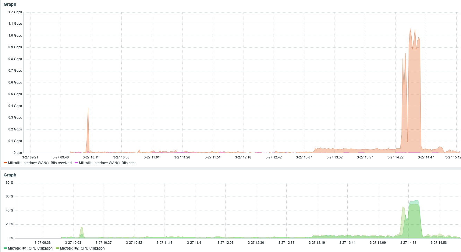

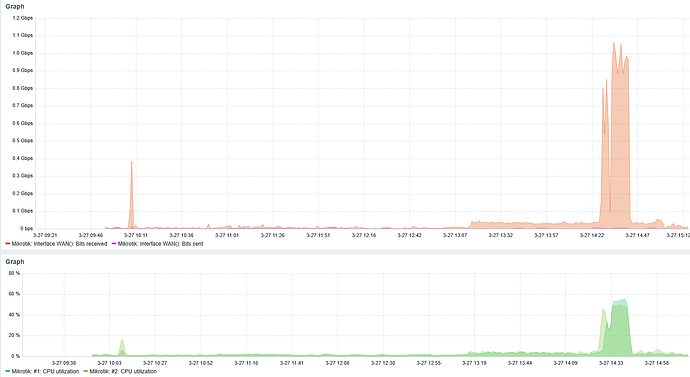

I opened separate topic because this time I wish to fix thruput issues on my Hex (2025) router.
Configuration is like below, I know VLAN1 should be removed and will be very soon but must be there for few more days.
All the VLAN’s: 99,100,110,120 are build to replace VLAN1 and VLAN88.
Problem: computer wired connected on VLAN99 is able to generate max ~500Mbit/s download speed instead of 1Gb/s which should be available.
Goal: implement successfully FastTrack rules.

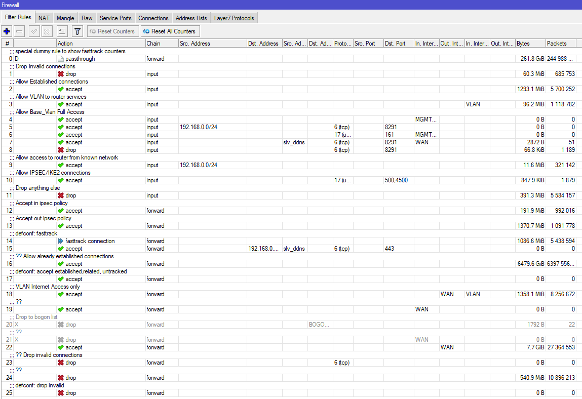

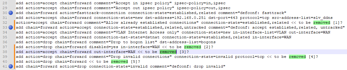

I know that my Firewall rules needs to be adjusted. Hope you will help me do that too. I count on you!

Hi guys
I know that this is not easy example, but there is a a lot of easy examples but here on forum some peoples are also looking for more advanced examples and it’s really hard to find such examples.
I gave here full router configuration, ready to clone for anyone.
Could you help me adjust it a bit to implement Fasttrack rules with one condition, the traffic from LAN could be IPsec traffic as well. This router is also providing VPN connectivity for remote users.
I hope that someone will help me here

Hi guys
CGGXANNX based on your advice and my current config I’ve prepared summary. This is a part of my firewall config specific to Forward chain:
add action=accept chain=forward comment="Accept in ipsec policy" ipsec-policy=in,ipsec
add action=accept chain=forward comment="Accept out ipsec policy" ipsec-policy=out,ipsec
add chain=forward action=fasttrack-connection connection-state=established,related comment="defconf: fasttrack"
add action=accept chain=forward connection-state=new dst-address=192.168.0.251 dst-port=443 protocol=tcp src-address-list=slv_ddns
action=accept chain=forward comment="Allow already established connections" connection-state=established,related << to be removed [1]?
add chain=forward action=accept connection-state=established,related,untracked comment="defconf: accept established,related, untracked"
add action=accept chain=forward comment="VLAN Internet Access only" connection-state=new in-interface-list=VLAN out-interface=WAN
add action=accept chain=forward connection-nat-state=dstnat connection-state=established,related in-interface=WAN
add action=drop chain=forward comment="Drop to bogon list" dst-address-list=bogons
add action=drop chain=forward disabled=yes in-interface=WAN << to be removed [2]?
add action=accept chain=forward out-interface=WAN << to be removed [3]?
add action=drop chain=forward comment="Drop invalid connections" connection-state=invalid protocol=tcp << to be removed [4]?
add action=drop chain=forward << to be removed [5]?
add chain=forward action=drop connection-state=invalid comment="defconf: drop invalid"
Maybe for better visibility I'm attaching screenshot:
Rules with blue ball are added (exact copy from recommended example), those with “to be removed [x]” are problematic for me.
Those [1] and [2] are obvious to be removed, but I need your advice with [3], [4] and [5] and maybe others need to be adjusted. Could you help me here?
Regards
Slawek
Finally, It’s implemented and working. Almost perfectly :wink:
Yesterday, I turned on rules: 14, 17 and 25.
This is the situation after ~12h.
I still have doubs about rules 16, 21, 22, 23 and 24. Can I remove them safetly?
Should I change something in my rule set? any recommendation?
There is one annoing problem which started exactly once I did all the changes.
From laptop (W11) using build in VPN client I have trouble to estabilish c2s session. It’s hanging on “verification user logon”. I found workaround - just open winbox and connect to my router helps to estabilish VPN to the same router.
No idea how it’s connected with yday changes. Maybe you can help me with this problem too?
Here you can see the Hex S performance (just router with few VLANs, no PPPoE)
Regards
Slawek
Screenshots don't include enough settings of firewall filter rules to be sure whether some rules do anything or not. Post output of /ip/firewall/filter/print (run from CLI), that one is more or less complete with all properties.
Here you are:

At first sight:
#17 looks like a subset of #18
#26 a subset of #25 (#26 will never be hit, after a "drop everything" rule)
  • As @jaclaz wrote, you can remove #17 and keep #18.
  • Current rule #16 should be moved below the "established,related,untracked" original rule #18 (and also after the "drop invalid" rule, see below).
    For the bulk of the traffic (the very large majority of the packets), the connection state would be established. When you download a 150KB JPG image for example, then usually only one packet has state new, while the other 100+ ones will have state established. You would want the packets in the established to be handled as soon as possible, skipping the other rules below immediately. Of course, fasttrack already helps in this case, but for the cases where fasttrack is not working or not enabled, you don't want to have rules that only act on packets with connection state new to be placed higher than the rule that accepts established in the chain.
  • The chain=forward action=drop connection-state=invalid rule should be placed right after that original #18 rule.
  • Once you've got the "accept established,related,untracked" and "drop invalid" rules at the correct positions (high in the chain, only behind fasttrack and the two special ipsec related rules), then all the other accept or drop rules below them no longer need connection-state=new and that condition can be removed from those rules.
    The possible values for connection-state are new, established, related, untracked, invalid, which means once you already have the 3 rules (including the fasttrack rule) that catch and handle established, related, untracked, invalid, the only possible connection state for the packets caught by other rules below them is new. It is thus totally redundant and unnecessary when you also specify connection-state=new on them. Any packets they can see already only have that connection state.
  • The original rule #20 is fully redundant (already handled by original #18) and should be removed too.
  • When you have the catch all rule (original #25) then you normally don't need the original rule #22 anymore, because no other rule between them explicitly accepts things coming from WAN.
    But you can still leave it there if you want, in case you might insert some accept rules in between and forget to handle incoming connections from WAN with those. With normal traffic (not under attack) only a small ratio of the packets has connection-state=new, so having a few unnecessary rules below the rules that handle established, related, untracked, invalid doesn't affect the performance too much.
  • If in the future for some reason you are not able to use fasttrack anymore (for example you want to use simple queues, or all traffics need mangle) then when you disable the fasttrack rule you should also move the two ipsec rules below the "accept established, related, untracked" rule to prioritize it as much as possible. Without fasttrack, the difference between having to only process 1 rule instead of 3 for most of the packets is very much noticeable.
    With fasttrack enabled and active, then you need those two rules above the fasttrack rule, because from your config, it looks like IPsec is in use.
