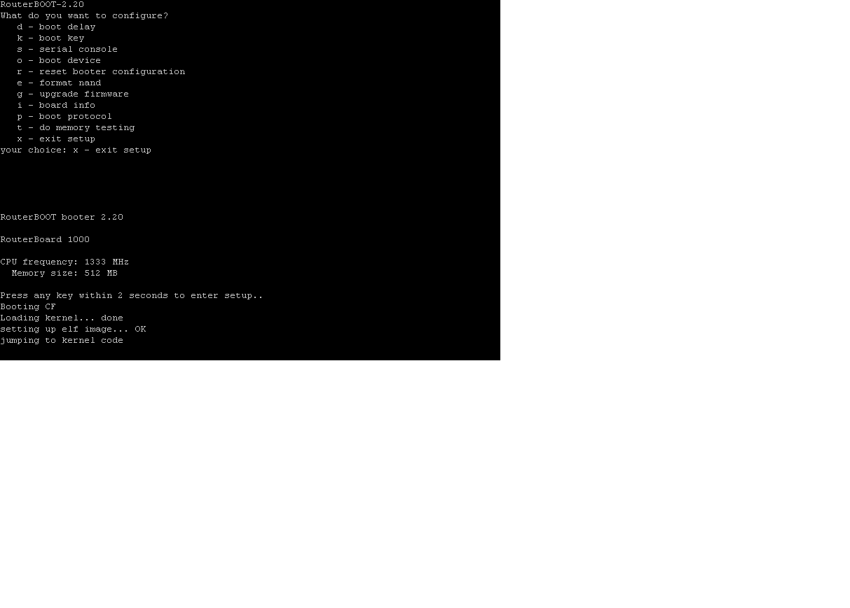

Here is a screenshot…
It reaches here and nothing happens and just stays there forever…
On rb600 it worx fine.
