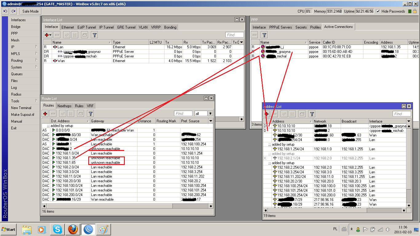

You probably have the same problem a few months, every now and then I have to reset the gateway to fix the unknow reachable gateway / ip routes for PPPoE sesion.
Prinscrean the problem with the version 5rc7
Version 5.2 is the same

You should not use interface in your static route configuration, instead use an IP address.
So when the PPP disconnected temporarily, the static route/gateway wouldn’t be changed into “Unknown unreachable”, it would be just “xx.xx.xx.xx Unreachable”. When the PPP interface got reconnected, the gateway would be automatically back to “xx.xx.xx.xx reachable through ”
