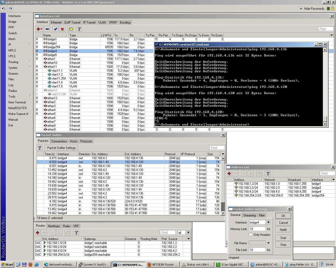

At first I reseted the board, flushed the firewall rules, set up 10 VLANs and bridged them to port 1 to 10. I also set up IP and MAC addresses for the bridge interfaces. Routing works fine between most of the networks but sometimes (I don’t know why) some hosts don’t receive ping replies. I used the packet sniffer in winbox to debug this and I found out that the ping packets were answered by the destination but they were not routed back. I also used Wireshark to confirm this on the sending PC. No answers were received. Pinging the same destination from an other VLAN was no Problem.

-router sees outgoing and incoming ICMP packets with identical payload (must be the same ping)

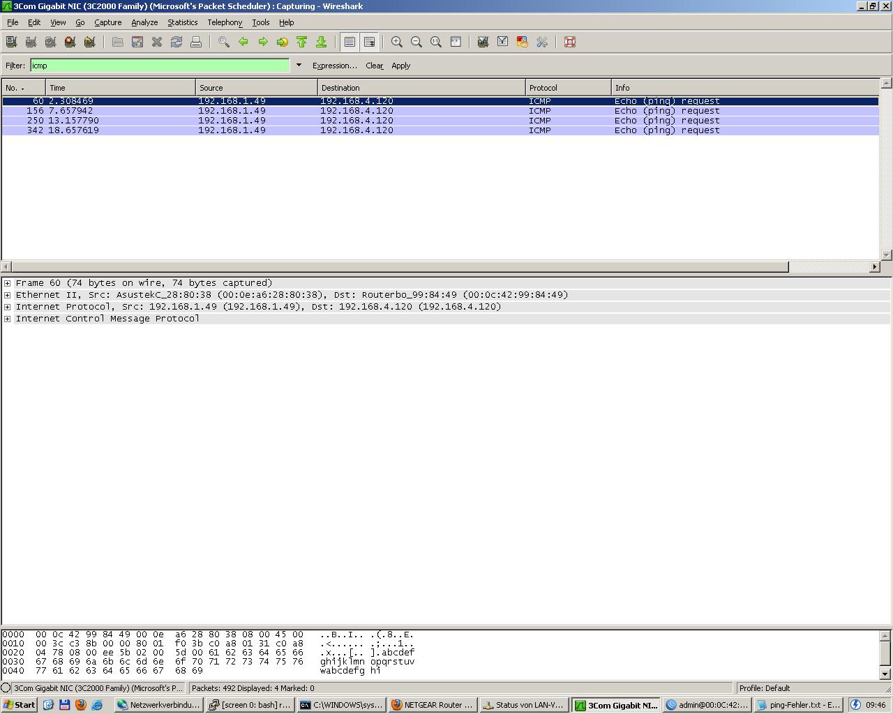

-PC only sees his own sent packets (local Wireshark)
-answers don’t get routed without any noticeable reason

Please also have a look at the screenshots attached to this post.
