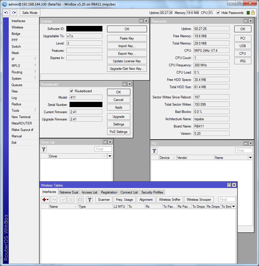

First of all, plugged in the RouterBOARD, updated it to RouterOS 5.20, all working like a charm. Shutdown board, unplugged from AC source, plugged the Wireless card, startup and Winbox > Wireless > Interfaces… Nothing.
Went to System > Drivers… and nothing appeared. So, I thought that the card needs driver installation. Searched the forum and a lot of people got the same reply “Mikrotik Wireless card’s drivers are always installed.” But I see nothing… In another forum post, I found that someone checked at System > Resources > PCI and got an UnknownDevice in the list, so I checked it as well and again: got nothing…
This RouterBOARD has a level 3 license, and checking the different license levels (http://wiki.mikrotik.com/wiki/Manual:License) I found that level 3 has limited wirelless functionality… and I was thinking if I need to upgrade to a level 4 one… but the wireless card it doesn’t appear anywhere before upgrading, I am scared to upgrade for nothing…
I would like to know what’s wrong here… if the Wireless card is not working, or it’s something about drivers, RouterBOARD,… I am confused.
Winbox Screencap:

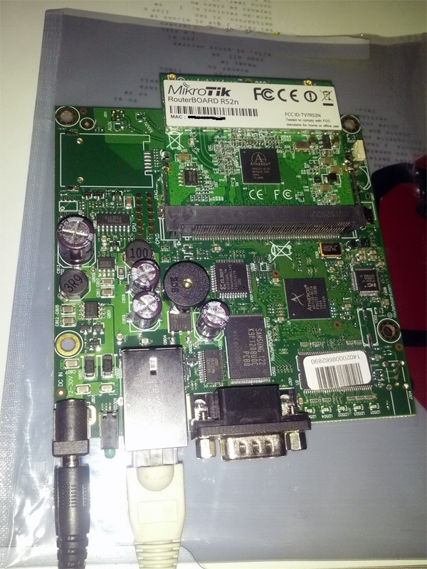

Photo of the current RouterBOARD. It is neccesary to buy a box and ground the board?

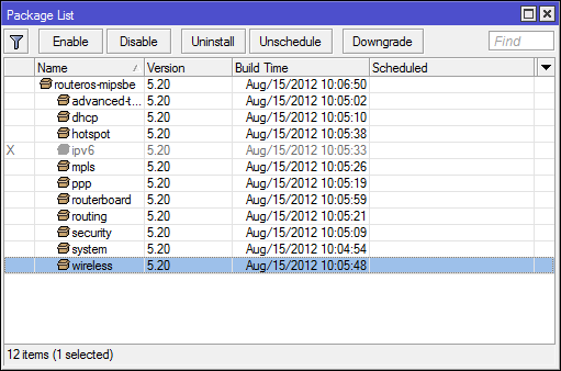

also - do you have the wireless.npk package installed? (check system packages menu)
Yes, I checked the packages list, and I have installed and enabled the Wireless one.

I highly suggest first attaching the antennas, and only then turning on the device, because when card is turned on without antenna, the high output to MMCX or uFL (in your case) will return back and can damage the card.
Thanks :open_mouth: I will be careful about this next time I plug a new Wireless card on a RouterBOARD. :slight_smile:
