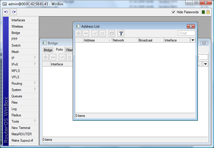

I have the same problem. I have two RB433 and two RB433AH here on my table, all of them have IP175D chip. When I connect via winbox (MAC) to ether1, it works fine. But when I connect to ether2 or ether3, I’m not able to change anything in winbox. Windows IP/Addresses and Bridge/Ports does not show anything and Add button (the red cross) is disabled. Sometimes aftew some time (one minute) it appears, but still changing any value in winbox does not affect the board. And winbox window does not close immediately, it stays for a few second (frozen) and then closes.

Plus when I assign an IP address to an interface (or bridge all ports and assign it to the bridge) and then I connect via winbox using IP address, it works fine - I mean I can change all values, no problem.

To kirshteins: I myself do not need such a large packets. But what about the connection to ether2 and ether3 via winbox using MAC? Is that a feature too?
