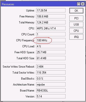

Looks like it work as ZX Spectrum :slight_smile: Check your 100MHz cpu :slight_smile: Seems to be 680.. I need it work on Monday :frowning:

(my CPU Speed is 680 mhz and i have V 5.14 on the Router)

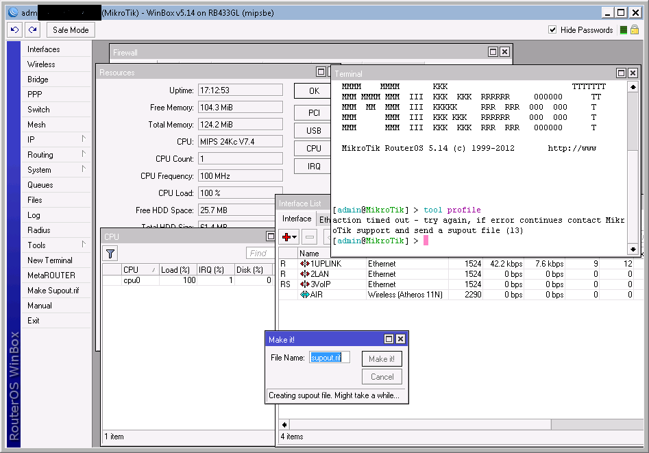

take a suppout.rif and send it to MT support@mikrotik.com
maybe they fix this faster… my customer alittle becomes MAD (((
Have you looked at the profiler to see if you using all CPU, and is so what’s eating the most cpu?
Yes few times was shown to me, firewall eats (and every time profile sends me to a mikrotik support, because can’t display something from profile), but if I have 100 Mhz in settings, I thing a fly will eat it too. With my configuration or (not configured), throughput is not above 20 Mbps, and local BTESTS with this HW is 100% CPU usage everytime.

changed my cpu Mhz to 680, it becomes faster, but throughput not more than 30 Mbits
