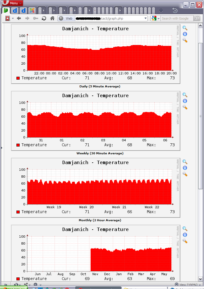

This is my RB450G placed in a rack with heavy throughput. Here 65°C seems like it’s minimum (: And I don’t have problems (at least temperature related) with it.
