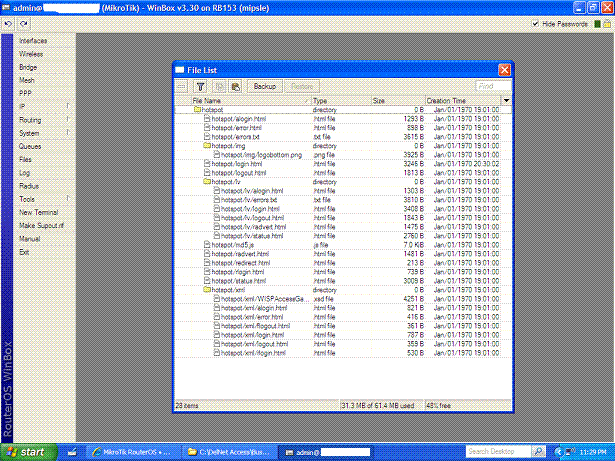

I have an RB-153 (running ver 3.30 firmware). I am trying to backup the configuration in-case something happens and i have to load the configuration on a backup RB-153 which I have in stock.
When I go to the [Files] menu in winbox… Winbox doesnt show the root directory??? odd? All the files list shows is a folder called “hotspot”
In the Fileslist window, there is a button called backup… I am thinking that this button is just to backup the hotspot webpages and files.
Yet, I want to backup the entire configuration of the routerboard.
I am wondering if your export command would do what I am wanting done???
If so, do I have to go into the Logging menu and change “critical” from echo to disk in order to run the export to a backup file like I want?
Also, If anyone is familiar with the hotspot system on mikrotik, I am wondering how I can backup the hotspot users login and profiles information so I can load it on a new/backup RB153 incase it crashes on me at some point in time?
If you press the backup button in the Files dialog box, this should create a file that you shoul then be able to drag to a folder on your PC.
Do note that this creates a binary backup file and is ONLY good to restore on the SAME device it was created from - the EXACT same device ONLY.
To get as close as possible a backup that MAY be usable on a board of the same model, use the export command which shall also create a file in the Files dialog box. This is a text file and you could either use the import command or try to paste is via the command line to restore the config.
The logging has nothing to do with backups - it was only in response to another query.
