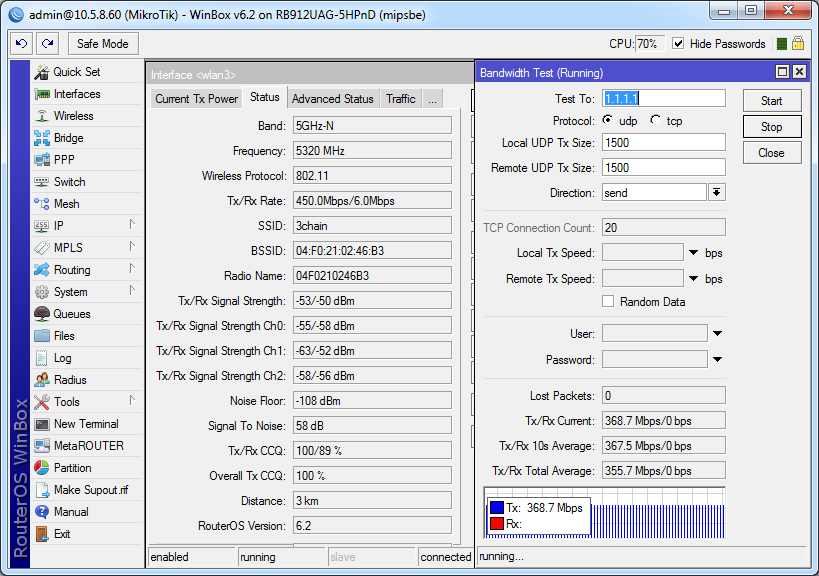

UDP
Normis said: Challenge accepted!
O_O! and TCP?
I just found picture in Uldis presentation. I don’t have a setup to test.
Not much. Just around 250 mbps peak TCP traffic in ap bridge mode. 3x3 mimo Sparklan WPEA-127N in PCIe slot. Indoor, about 10 meters. Any thoughs?
As you can see, the cpu is not the bottleneck.
CPU is simply maxed out by using second band (2.4) with about 80mbps tcp traffic in addition to 200-250mbps at 5ghz band.
