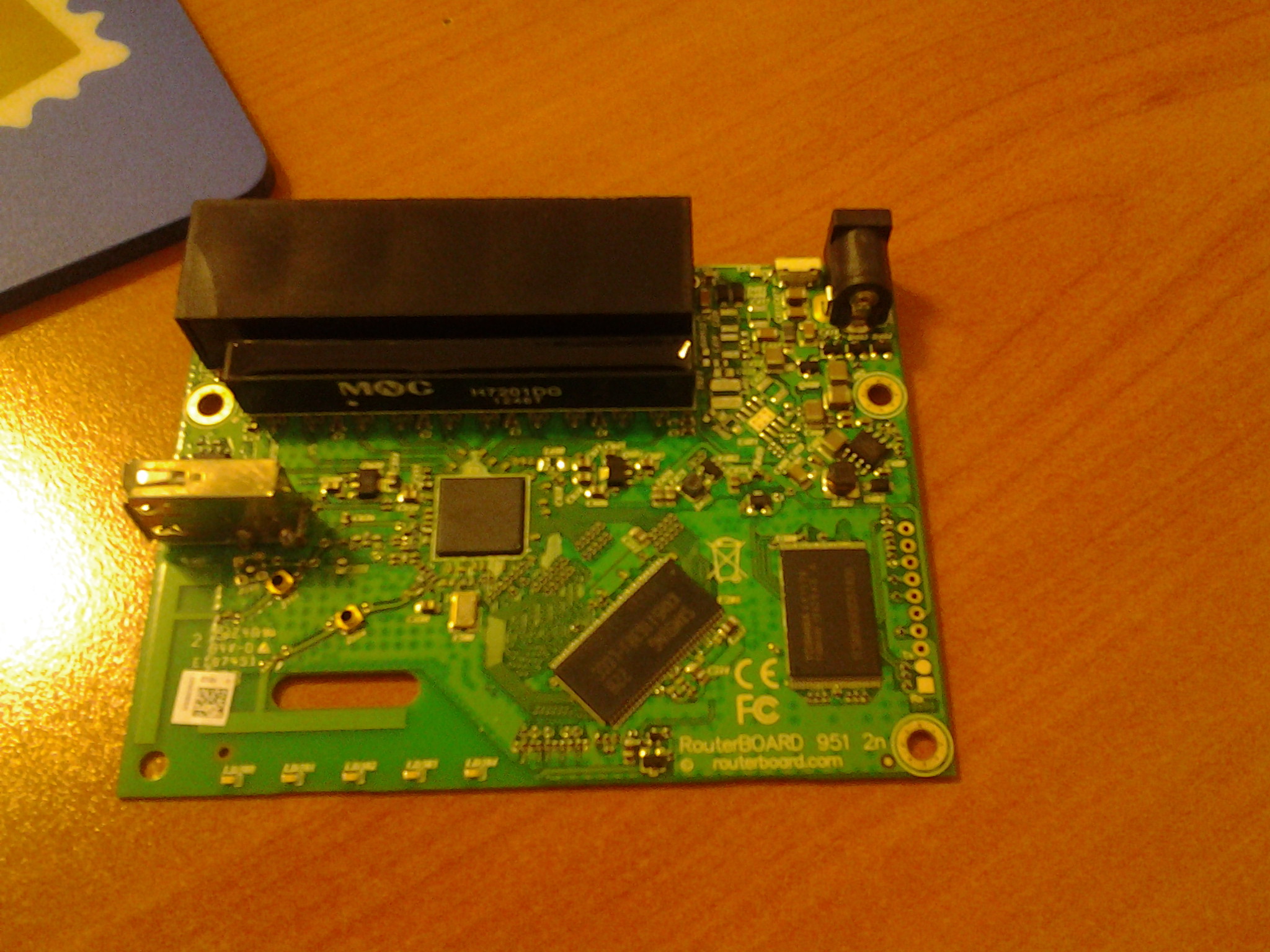

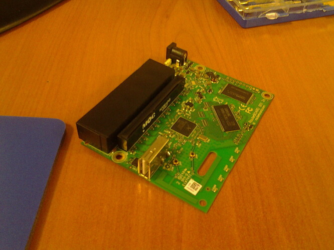

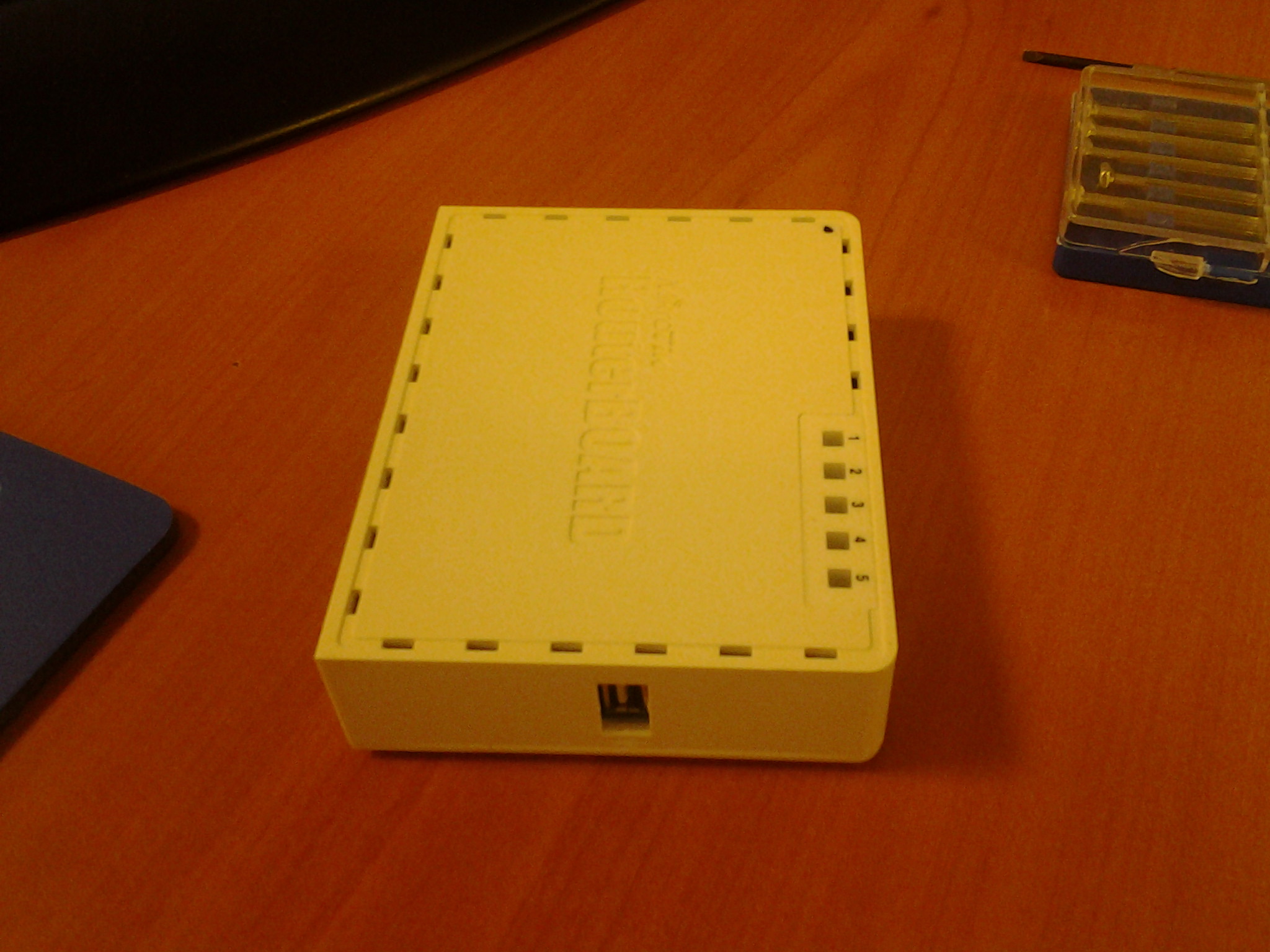

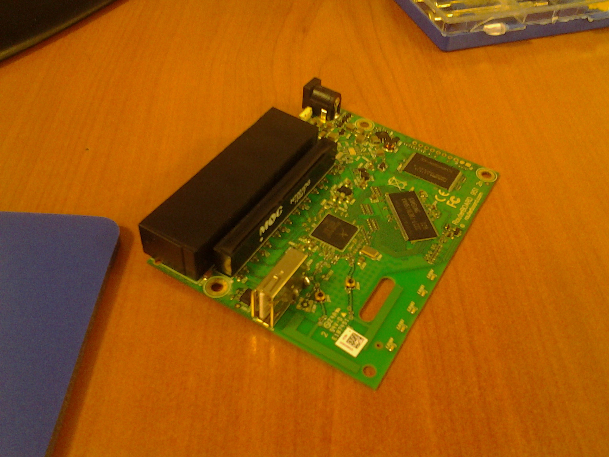

Hello to all,
I wanted to share with you my edit :slight_smile: I added the USB port of a sxt damaged on my 951-2n and it works perfectly.

Did you do anything else to the routerboard, or did you simply solder the port? Have you used it with a pendrive or usb modem?
What else elements you use for it?
It works perfectly with 3g huawei, for it to work I simply soldered the usb port;)
