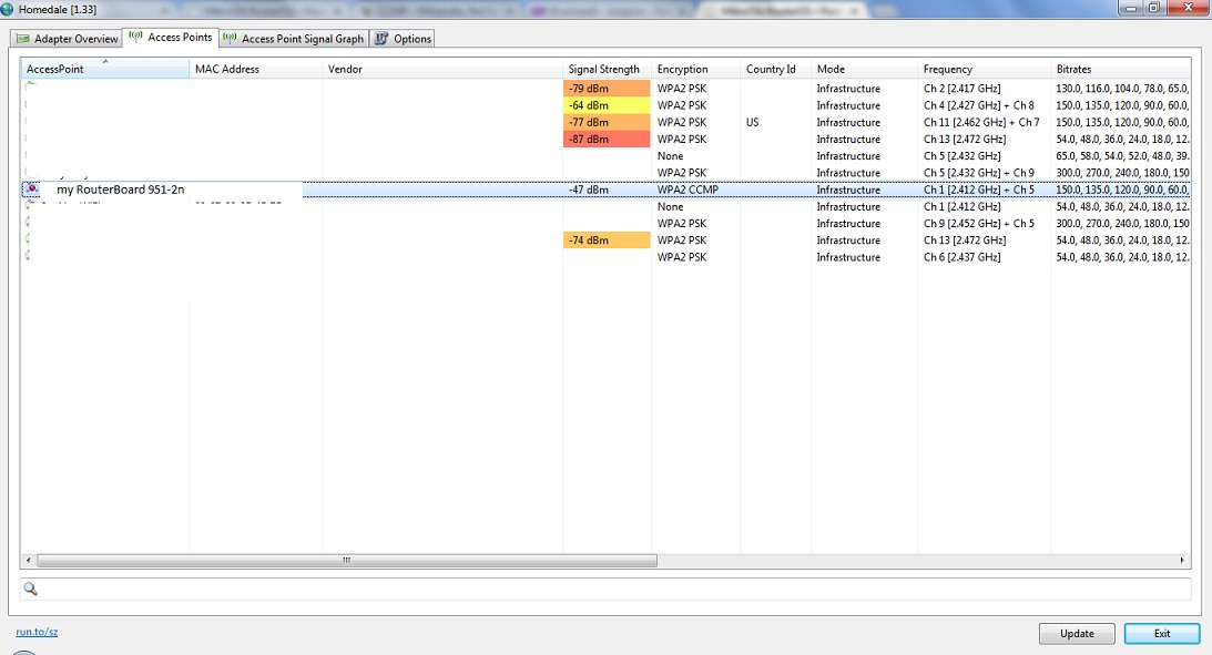

WiFi constantly disappears from my wireless acces point list.
is it an interference problem or a hardware issue?!
It disappears in some software you are running or the actual wireless interface disappears?
wireless interface disappears.
I can see other wifi spots but mine not.
Yes, I have seen that with the 951-2n as well. Going to v5.20 some months back helped out a lot, but then the performance would randomly drag occasionally, so I only allow devices I don’t care much about to connect to that wireless device.
