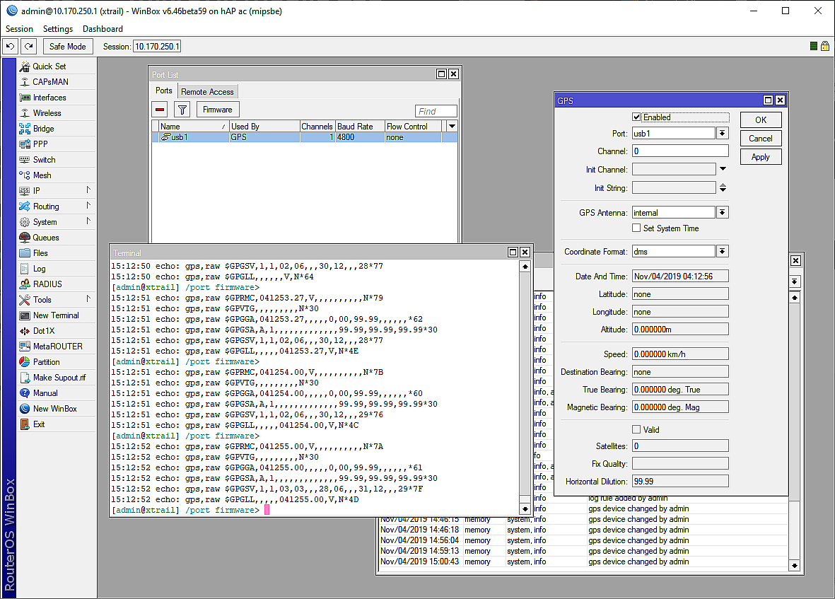

and having major issues getting the gps to work on this router.. the GPS WAS working in a really old routerboard but since putting it into the 962UiGS it simply fails to lock to locations
see attachment for what i am seeing

Same orientation , the strange bit is if I change the port speed over and over it can come to life with a really good lock until the device is rebooted then its back to the same. The unit is in clear sky and in open
