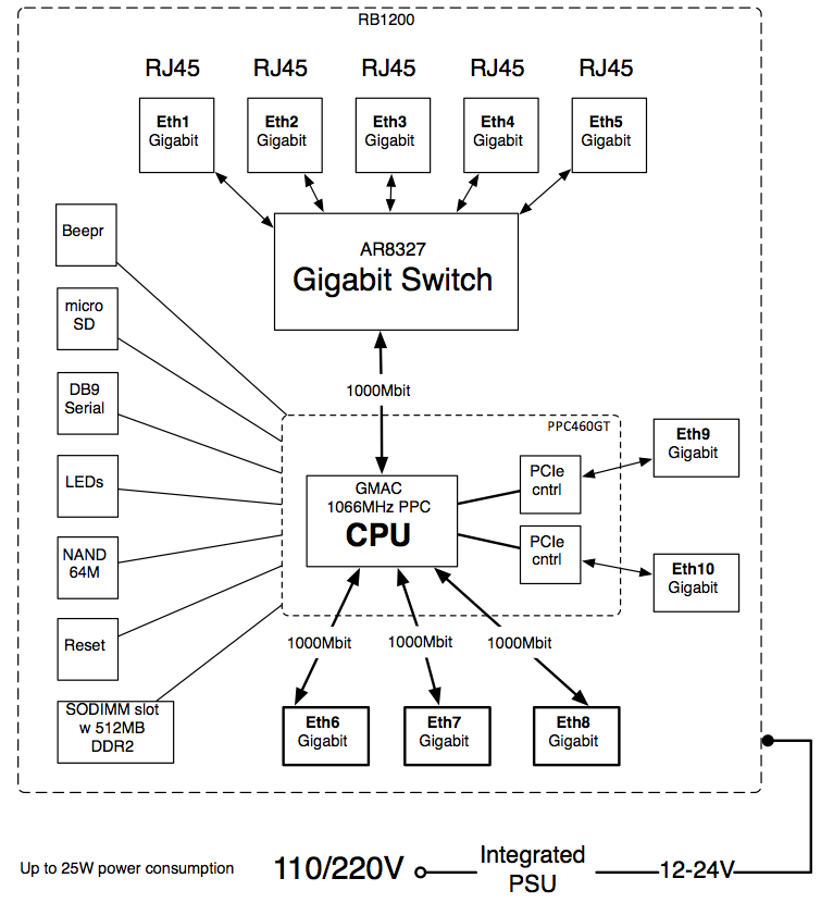

I stand by my advise, RB1200 will be probably the best performing board of the three.
Let’s look at it’s block diagram:
If you were to use just the RB1200 without an additional switch, most optimized setup will:
  • Create a switch group on ether1-5, (make ether2-5 slaves of ether1) connecting any devices that need to intercommunicate amongst theirselves on them.
  • Use any of ether6-8 (direct dedicated CPU lane) for Fiber.
  • Use any of ether6-10 for sectors or other devices who shouldn’t communicate between them.

@Pukkita, your block diagram is great and helps me understand the setup, and apologies for not having said this, ether 2 and ether 4 on the RB 1200 are damaged so are unusable. with your diagram and suggested setup could i say ether 6-9 be used for connecting any devices that need to intercommunicate amongst theirselves and use ether 1,3,5 for the fibre link with the valns?
No, 1,3,5 are still the best ports for devices intercommunicating. If you need more ports, you can either connect an external switch (or external RB switch group) to 1, 3 or 5 (creating a switch port with 1,3,5).
