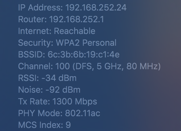

The default config for the wireless should be pretty good. The only thing I changed on my hAP AC is locking the channel on 100 and enabling WMM. I get a consistent 1300mbps link, and smooth 350~375mbps throughput.

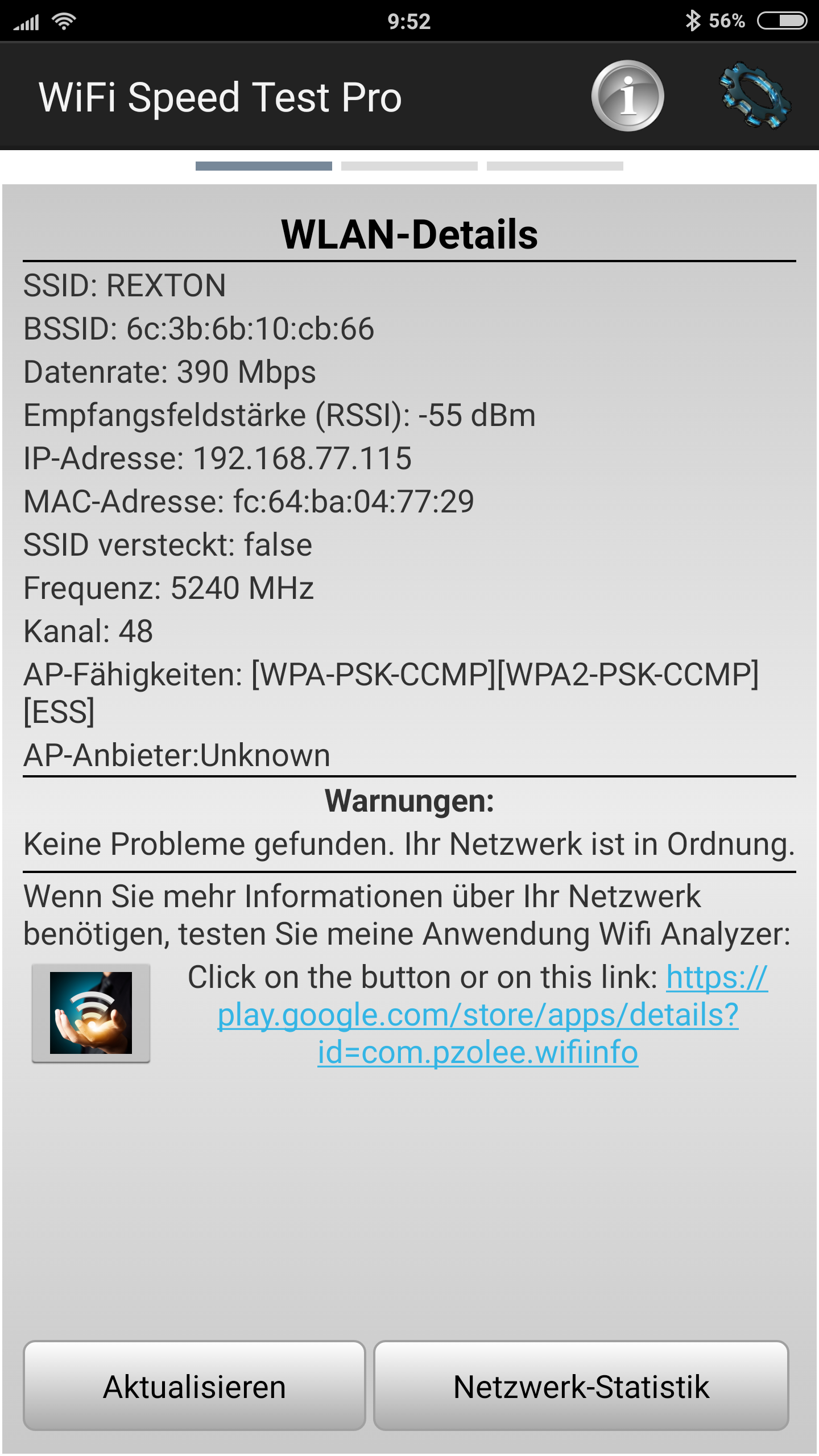

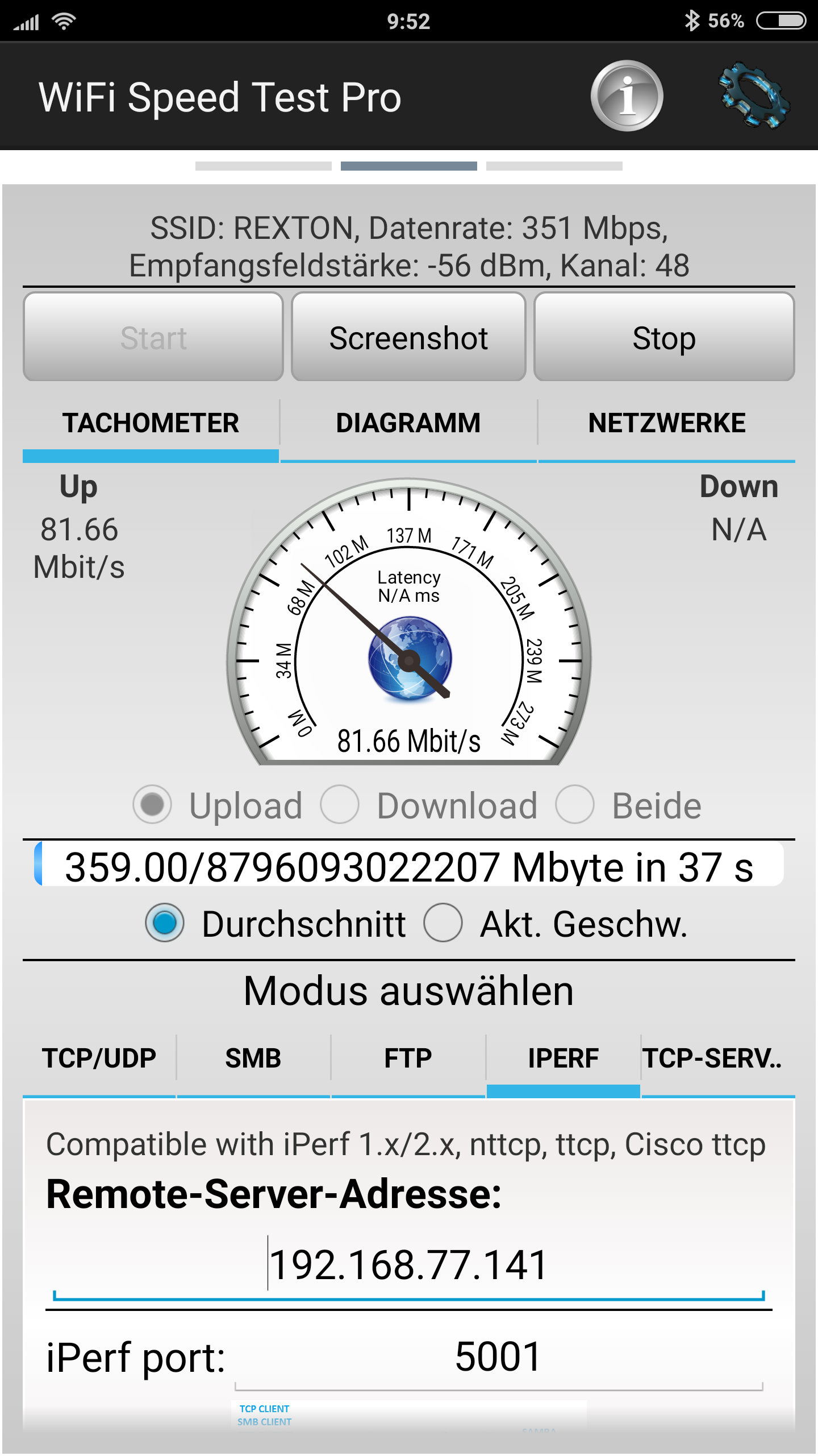

Can you show me your exact configuration?
I reach max 80~110mbps throughput over wireless (CAPsMAN)
FW: 6.37.3
Country: switzerland
Frequency: 5240
Width: 20 / eeeC
WPA2 PSK / aes ccm
I can tell you right off.. Change to 80Mhz Ceee
I tried all the settings. Also following the list here: https://en.wikipedia.org/wiki/List_of_WLAN_channels
Always when I set 80MHz, stands unsupportet configuraton (Country: switzerland with CAPsMAN). So I ask for the configuration to see what I do wrong? :wink:
In CAPsMAN it is different. Channel width should be 20MHz and you should use Extension Channel setting to choose wide the total channel should be.
I have already tried various (with CAPsMAN and without CAPsMAN), but I never get a link higher than the screenshot.
Can someone post a working configuration, with consistent 1300mbps link? The configuration can also be without CAPSMAN, If possible with country Switzerland.
5240/20-eeeC/ac/P(20dBm)

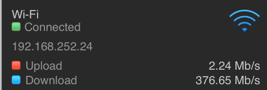

@IntrusDave how to get Channel 100 on Mikrotik wAP ac ?
I’m not too much into mac but as far I know Mac Air doesn’t have triple chain wifi, I had new Mac Air yesterday at work and it showed as dual chain in device manager, also connected 867mbit
