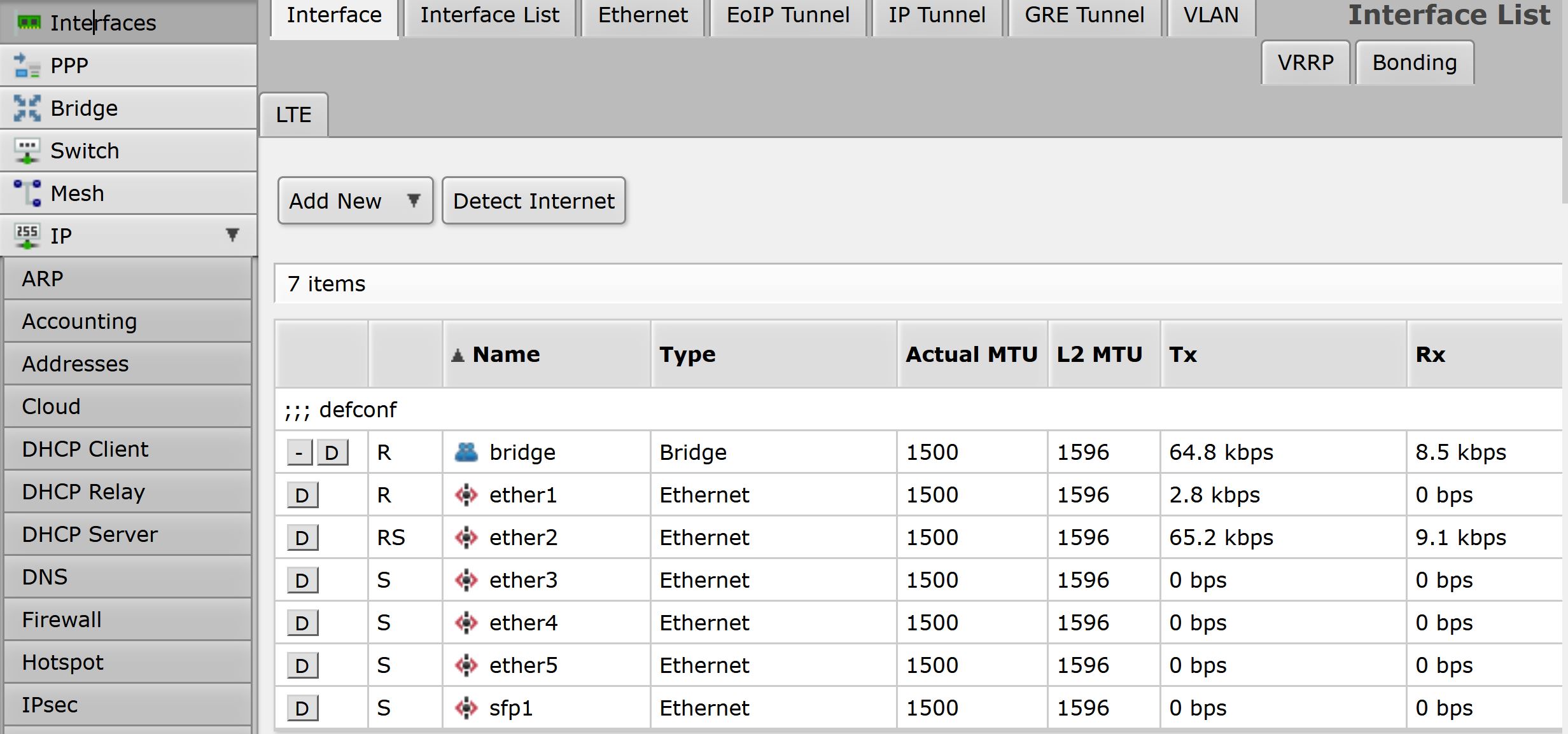

I got my MikroTik Router hEX S today and I want to provide internet access with each separated networks to three households over one fibre modem (Genexis FibreTwist G2110).
The Modem is connected with Ether1 and my client computer is connected with Ether2.

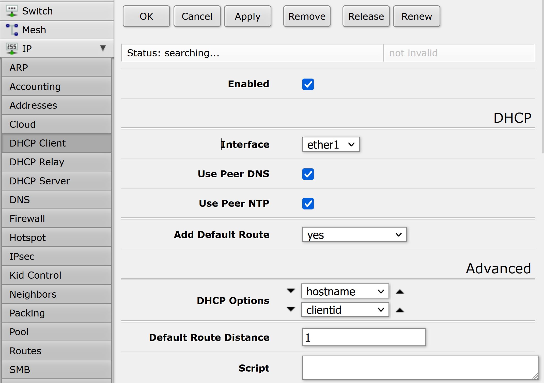

Also I added a DHCP client to Ether1 according to the following documentation: https://help.mikrotik.com/docs/display/ROS/First+Time+Configuration#FirstTimeConfiguration-ConfiguringInternetConnection
But the DHCP client remains in status “Status: searching…” forever.

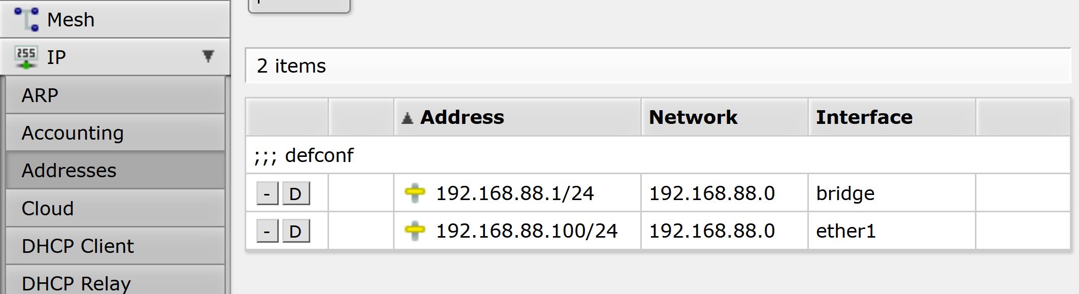

From the screenshot provided, you’re getting an IP from the same range as your LAN subnet (192.168.88.100) this is a non-working configuration.
Why are you getting 192.168.88.100 ?

This was my last try (manual configuration) after automatic connection with a DHCP client did not work. Also it was not the port for the modem, but for the client PC.

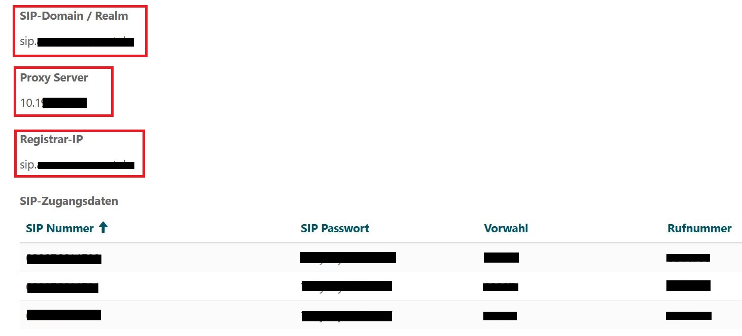

I actually have so called “login data” for the internet connection that look as shown in the attached screenshot. I’ve already noticed that before but I did not find any field within the Mikrotik Configuration to use those data for a connection.
Is it possible to configure the internet connection only with those given information (“SIP-Domain / Realm”, “Proxy Server” and “Registrar”)
Thank you again!
That information is only for SIP, nothing to do with your internet connection.
