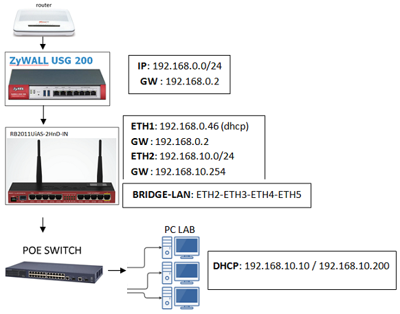

In Higher School I would like to create the following situation:
  1. Telecom Provider
  2. Router
  3. Zywall_USG-200
    IP : 192.168.0.0/24 - GW : 192.168.0.2
  4. RouterBOARD RB2011UAS-2HnD
    ETH1 : 192.168.0.46 (dhcp ) - GW : 192.168.0.2
    ETH2 : 192.168.10.0/24 - GW : 192.168.10.254
    BRIDGE-LAN : ETH2-ETH3-ETH4-ETH5
  5. PoE Switch
  6. labs : DHCP 192.168.10.10 / 192.168.10.200
Operations runned in Winbox
  • Eliminated the basic configuration
  • Installed winbox
  • Connected winbox with Mac address of the Routerboard device
  • Enabled the client dhcp to request an IP address Automatically on the ETH1 port
  • Created a Bridge “bridge-lan” between ports "eth2, eth3, eth4, eth5 "
  • DHCP Server for LAN: added the ip 192.168.10.254 on the" Bridge-lan "
  • Created the" pool-lan " 192.168.10.10 - 192.168.10.200
  • From network, set DNS and Gateway to communicate to devices: GW: 192.168.10.254 - DNS: 9.9.9.9
  • DHCP Server on LAN enabled : dhcp-lan> bridge-lan> pool-lan
RESULT AND CRITICAL
At this point the PC’s in the laboratory receive in DHCP the addresses on the network 192.168.10.X and dns 9.9.9.9 as setted by us, BUT IT NOT NAVIGATE on internet.
probably I need to create firewall rules.
CAN SOMEONE EXPLAIN TO ME THE CORRECT STEPS?
Thank you
make sure that u masqurade the ip that is comming from zy router
print you dhcp, ip, firewall configuration
