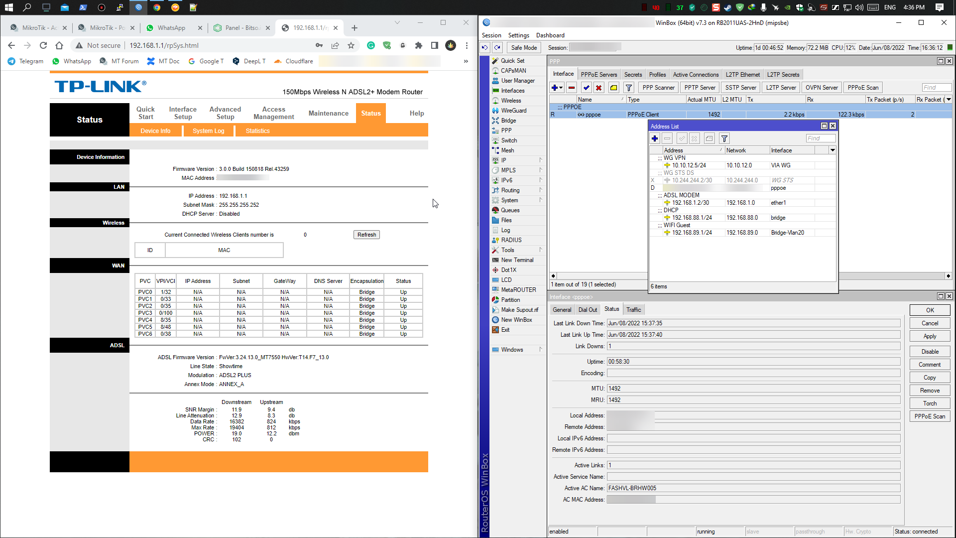

Do you have your Modem/Router from your ISP in Bridge more?
total noob please elaborate where do i check that?
@optimus0
The modem behind your MT.
