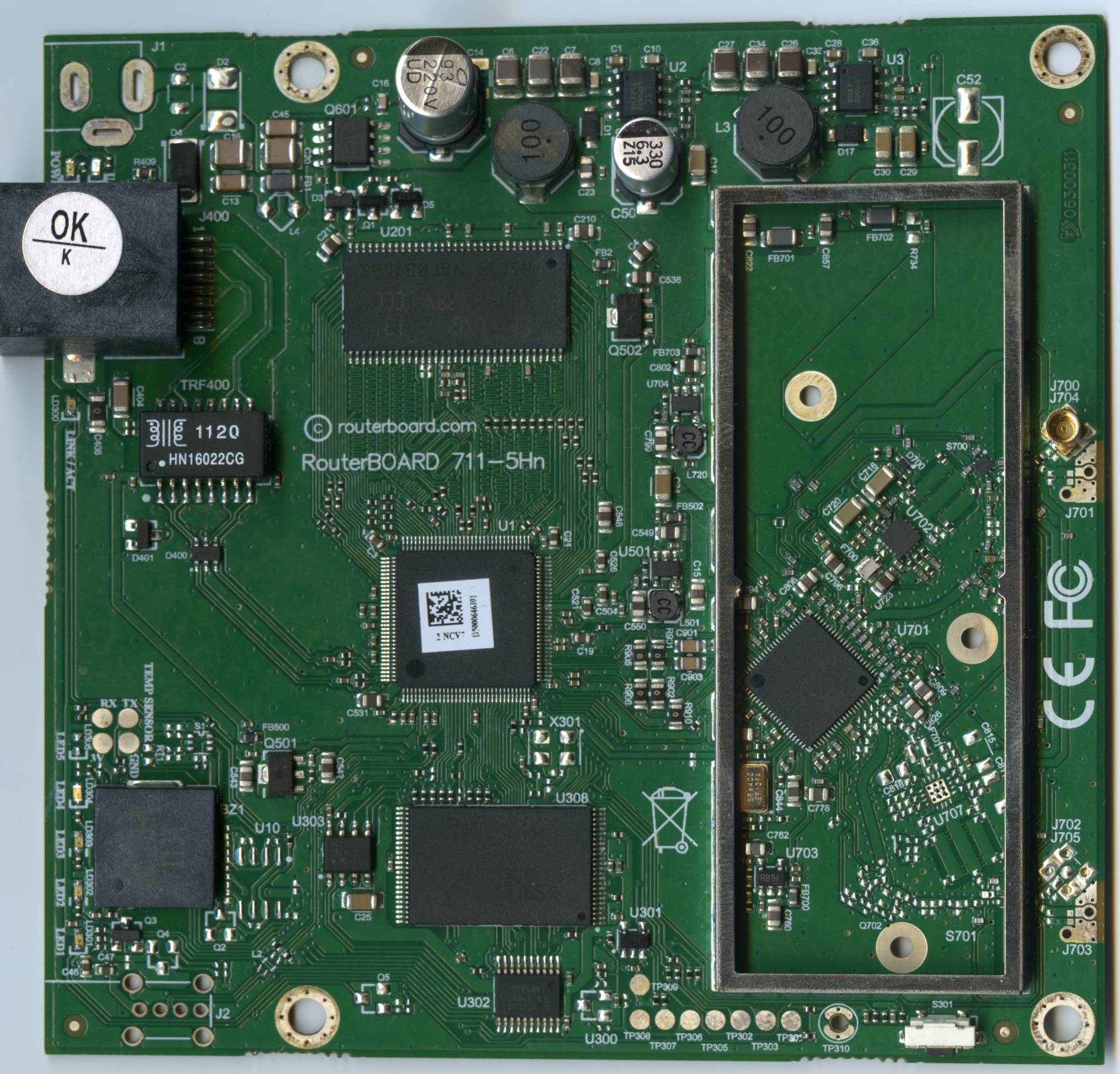

RouterBoard RB711-5Hn low TX power how to fix?
Hi. I also have a problem with a low TX signal as per the closed topic: http://forum.mikrotik.com/t/problems-with-new-revision-of-rb711-5hn/51789/1
I have about twenty such boards for possible repair (unfortunately no more warranty).
Literally nothing helps, so I recognize that the problem is hardware.
Is it possible to repair these boards? What could be the cause of the malfunction? Replacement of the processor?
I would like to repair them, because they used to work very well.

But generally if it affects just TX power (and RX sensitivity is fine) it must be caused by PA or possibly antenna switch chip. Because signal goes from antenna to switch and then there are separate RX and TX paths. On RX path there is LNA and on TX is power amplifier.
On the PCB switch is S700 and U702 is power amplifier. The RX path is probably to the right (fat PCB trace) with small SMD speck being LNA.
U702 PA could be faulty or there could be something wrong with supporting circuitry so it can’t run at full power (voltage regular issue? caps? hard to say).
If you have spectrum analyzer or power meter you can check if the TX power is still regulated when value is changed (but lower than it should be… but in that case PA chip is probably working) or if there is no regulation at all (PA is faulty or not getting commands to control power).
But all this is just a guesswork, it would help if support could at least tell you what the original problem was (which chip is faulty). These chips can be swapped with hot air and a bit of patience, for example from some other board with dead ethernet… but doing so blindly without knowing the real cause would be just a waste of time.

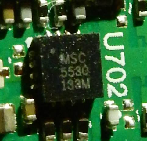

I noticed that the Tx signal is exactly the same whether the antenna is connected or not. Rx signal after disconnecting the antenna decreases.
This sounds like a faulty wireless PA to me.
Yes! :slight_smile:
I replaced the U702 chip with another one from the board after the storm and the signal did fine! :slight_smile:
The culprit was the circuit (amplifier):

PA is https://www.microchip.com/en-us/product/lx5535
If you search LX5535 on Aliexpress you will find some, best deal is for 20pcs for $20, but even 10pcs for $15 is OK…
Thank you :slight_smile:
But in description is Freq (GHz) 2.4-2.5. Will it work?
This one (LX5530) is for 5GHz: https://www.microchip.com/en-us/product/LX5530
Choose one depending on your board: LX5530 is for 5GHz board, LX5535 is for 2.4GHz version RB711.
