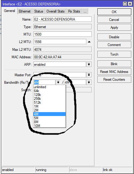

The problem is that I need to set specific speeds on each interface depending of each client.
For example:
The speeds that this RBs allows me to set is in the image below:
But I need to set for example 3MEGA and not 2M or 4M but 3M!!
Anyone could help me ?
It is a bug ?
When I try to set manually a get a error saying : decimal number expected!

It isn’t a bug, was already explained that is fixed list of values.
These values depends on built-in switch chip.
If you want to limit bandwidth to 3M, use queues.

you can enter any value in kbps, just type it in. The UI doesn’t accept 200M, it must be 200000.
I just tried 200000 for 200Mbps and it worked fine.
