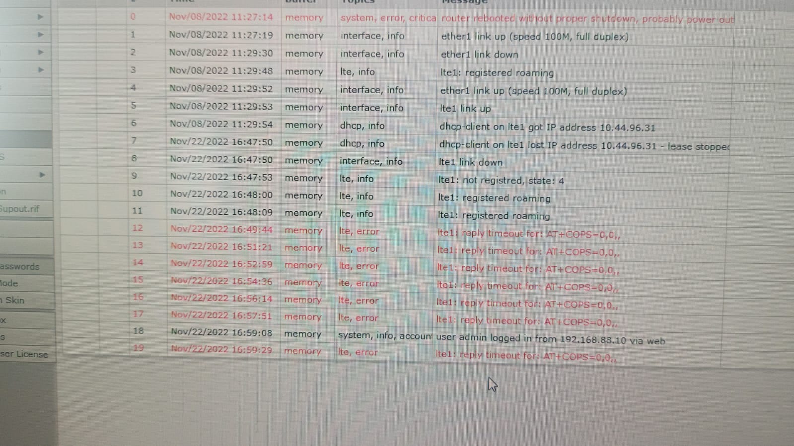

We tested hardware combination of RBM11G (ROS 6.49.7) + SIMCOM SIM7600 at our location with mobile operator
in home mobile network and it works fine -
after using that setup in roaming area the LTE card do not connect to mobile network.
It shows failure message in log > timeout for "AT+COPS=0,0, " <
I see this behavior already now in several areas and with different operators - so it`s no problem of operator.
Since it left home network (Telekom) it was not online anymore..
The SIM card is not restricted and allowed to do roaming (global) - we use same setup with HUAWEI ME909 without problem.
(At Huawei modem we use AT command to “allow roaming” - but i read SIMCOM card do not need that)
Please find attached log message.
