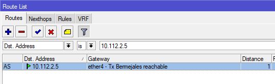

Problem:
Internet is functioning at the site through the routerboard (10.91.0.7).
I can access the radio on eth2 WAN (10.91.0.5) with no issues but unable to access radios on
neither transmits Aps ( 10.112.1.5 on eth3 or 10.112.2.5 on eth4).
When I ping either 10.112.1.5 or 10.112.2.7 I get timeout for the actually routerboard terminal.
Strange thing is that clients attached to 10.112.1.5 eth3, can access the AP and have active internet.
Neither the client nor I from the RB 960PGS, can ping or access neither 10.112.1.5 or 10.112.2.7.
When troubleshooting the issue, I see that both eth3 and eth4 are REACHABLE but I still can ping or access actual radios.
Any clue what is going on? I am stumped.
Any suggestions would greatly assist.
