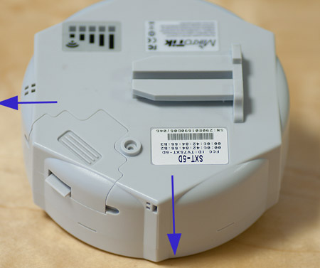

mounting bracket can’t be turned, you need a horizontal pole or some DIY adapter. We are working on new brackets.
OK, that is cleared, but what will come to the water exit holes of the unit? By turning the unit these will effectively become water entering holes and thus making that type of action fatal to the unit.
no, if you turn according to manual, all holes are still pointing down.
this image shows both polarizations and holes. as you see, no matter how you mount it, none of the holes is pointing up. don’t worry, we have tested, no water can enter in the sideways hole even if you point a waterhose at it
Normis, you SHOULD make a tilt bracket for this one!
