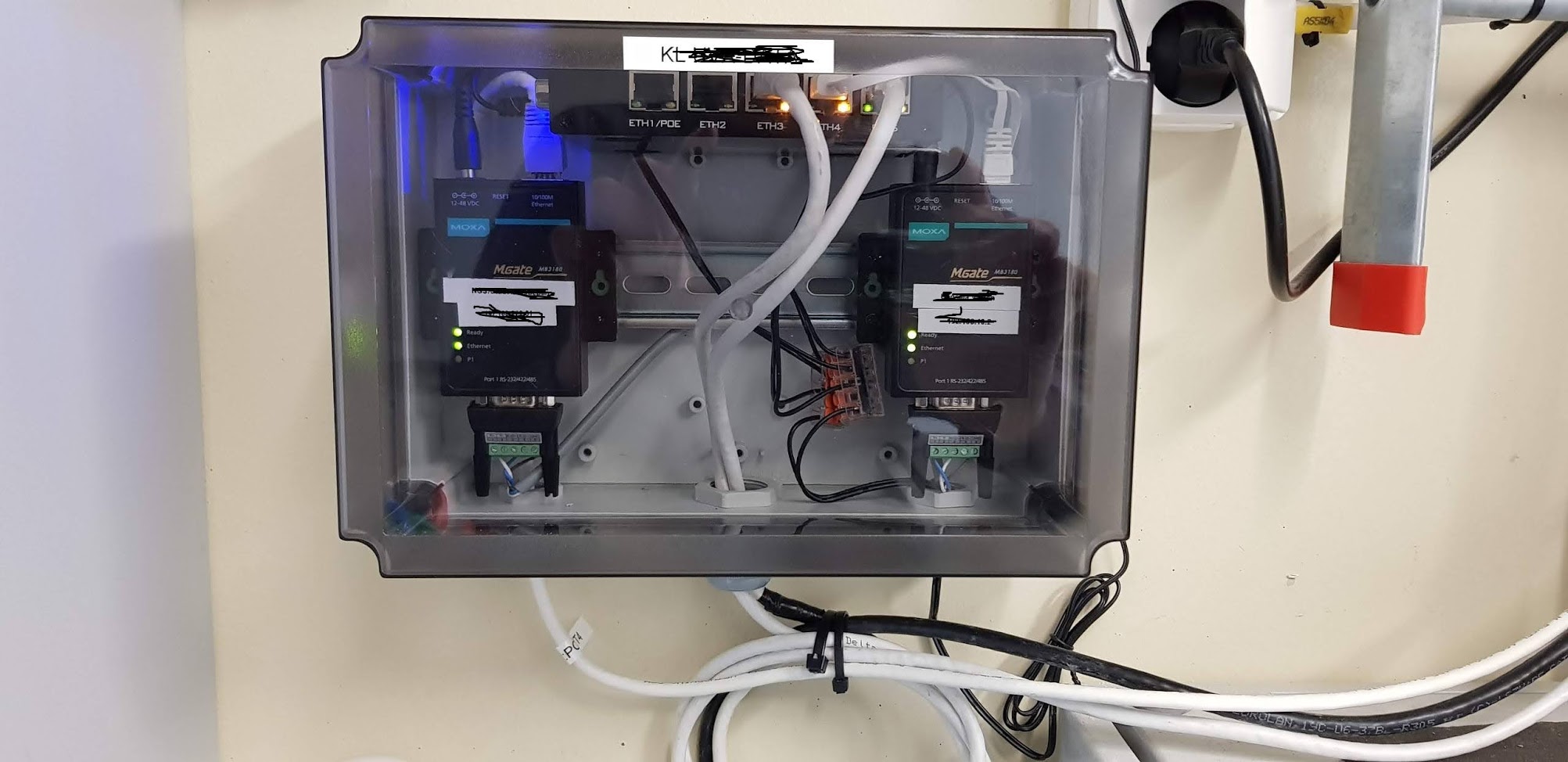

I love the bare form of RB450Gx4 since it allows me to easily add DIN mounting brackets and use these devices in industrial cabinets. Only thing I’m missing is an M.2 slot+SIM card slot so we could install a LTE or 5G card inside too.
I could use another RB model for 5G purposes but for some reason no routerboard have M.2? But optimally I would like a 5 port device like the RB45Gx4 to have it. It would be easy to drill a hole for a chassis antenna connector in the standard CA150 box).

For the RB450Gx4 I use these
https://www.moxa.com/en/products/accessories/mounting-kits/din-rail-mounting-kits/din-rail-mounting-kits
Screws fits perfectly in two cassi holes, works with only one of the two in the kit but it will not be super stable (you can see in pic 2 it is tilted slightly) but I think it is also possible to mount both in parallel if a rock stable mounting is needed.
For LTE we already have hundred DIN mounted modems deployed (which costed like 8 times a RB450Gx4) but I would like to start exploring 5G connections now that some operators have their 5G networks up but I guess it will be years before there are other industrial 5G modems available. And they are far from as advanced as routeros is so on some sites I needed both a DIN LTE modem and a DIN mounted RB450Gx4.
