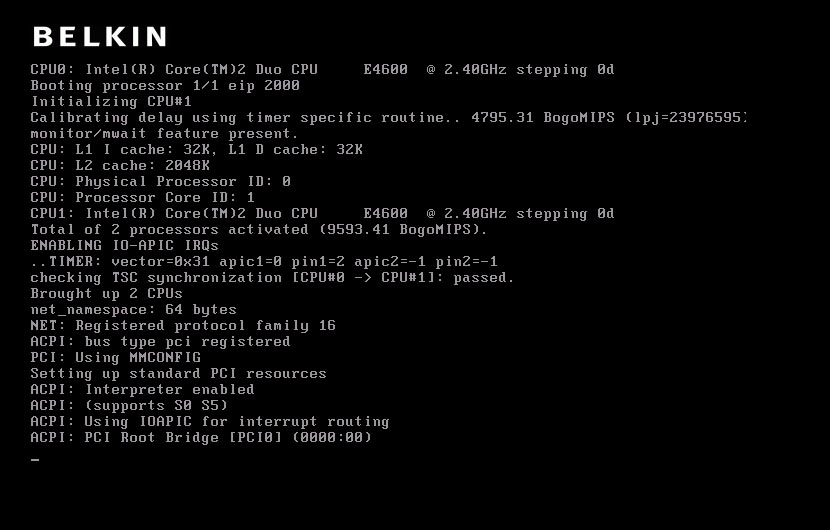

This system is unable to boot with multi-cpu=yes, if I wipe it clean and use the default multi-cpu=no, 3.7 will boot. If I then enable multi-cpu=yes and reboot, it will freeze at
ACPI: PCI Root Bridge [PCI0] (0000:00)
JPEG screenshot attached
Good news, just upgraded one of the routers to 3.14 and was able to enable multi-cpu and reboot, now it shows cpu count 2!
So the problem that existed in 3.5/3.6 doesn’t seem to exist any longer.
