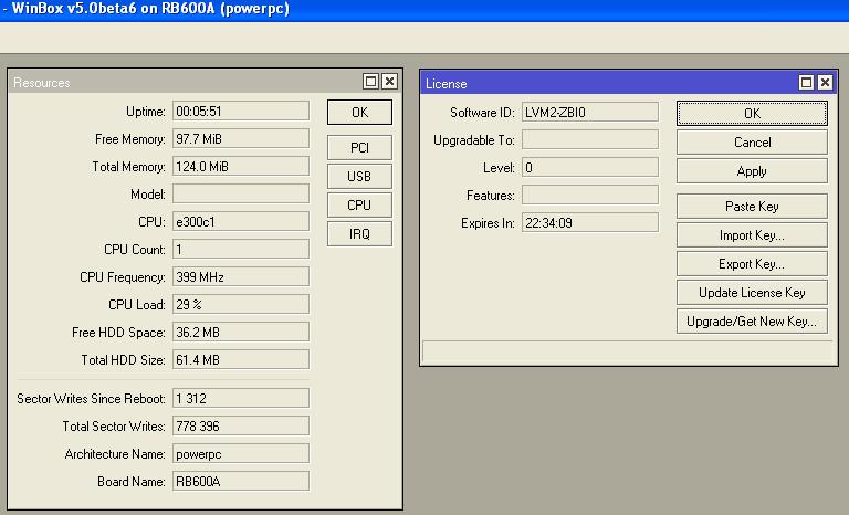

Hi I just upgraded RB600 routeros to v5.0beta6. Then it showed me window to update license key, but it shows that it failed.
The router is connected to internet. (I cant update license on it expires in 1 days)

It’s irrelevant if the router has Internet access, the computer running Winbox has to have Internet access. Did it? If yes, contact support at support@mikrotik.com.
The router and the computer running winbox are connected to the internet. The RB600 is a remote location I cant update license on it expires in 16 hours !!
Did you contact support?
what was previous version?
there’s no ‘failed’ on the screenshot ![]()
I was going to suggest you downgrade it if you can’t get the license updated in time, but from that screenshot it appears it has no license at all.

The problem is not with the procedures. Your router Does not Have a key to update.
Please send me your supout.rif file and I will make a new key for it.

actually do not see the description License Failed because I ran the screenshot before groped update the license key. sorry!
