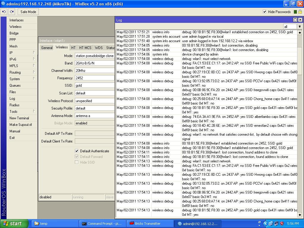

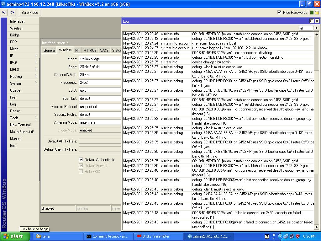

  1. configured as “Station PsuedoBridge” works fine. See third figure.
Connection failed when mode switched to “Station PsuedoBridge Clone” or “Station Bridge”. See first two figures. Overtime, RouterOS console hang.
