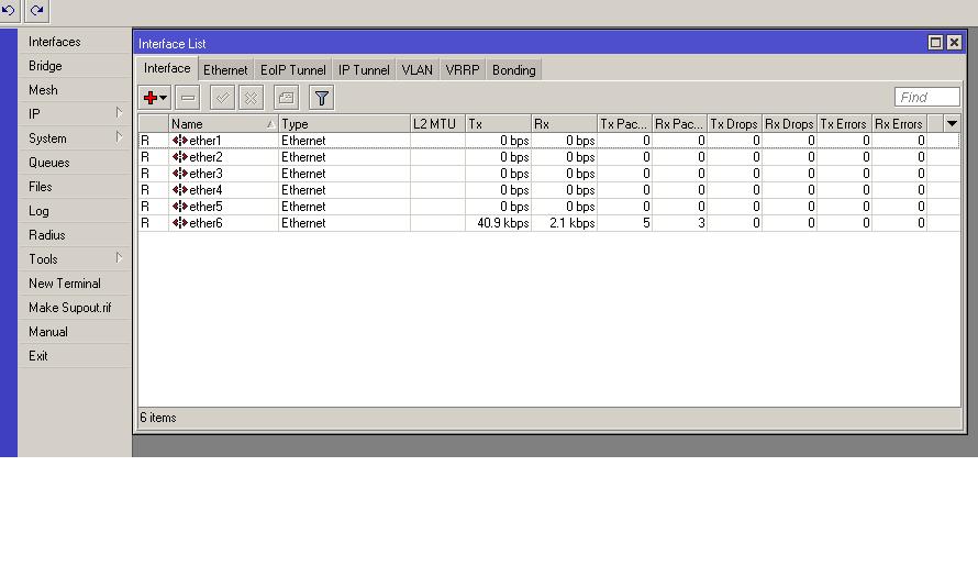

Incorrect status of the interfaces: all interfaces are “running” even if nothing connected.
That is normal for x86 as disable-running-check=yes is set by default.

Oppss, You right…
What is the command to make “disable-running-check=no”?
