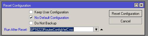

In RouterOS6 I had no issue in using WinBox System > Reset Configuration - and selecting the .rsc to Run After Reset – worked every time OK – blew away the current config and loaded the next one – no issue.
Now I’ve just updated to RouterOS6.1 – this feature does not seem to be working correctly, the system reset is happening BUT the assigned config file is not running.
BUT when I do a manual load of the .rsc in New Terminal (> import .rsc [enter]) – it loads without issue and without errors – and my comms links is working OK.
So has someone broken WinBox System > Reset Configuration - and selecting the .rsc to Run After Reset?

OK, script is working in New terminal for you (I will try tomorrow) BUT does the Winbox GUI work?
System > Reset Configuration (choose the file to run on reboot) ?

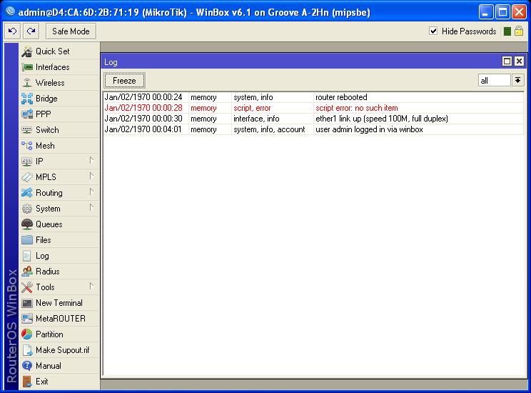

  • Then tried the GUI windows (rather than New Terminal) – again failed – after reboot I check the logs and there was a memory error there is a script error: no such item (but I can assure you it works fine if I import it) - see attached log screenshot.

You may need to add a delay when doing via script, fair enough – but what about the GUI method below? – this is failing on v6.1
It worked before on earlier versions, but does not consistently work now on all my hardware I have here, on one unit it always fails, one others it sometimes fails and the MikroTik supplier in Australia has confirmed my findings.

When you reset configuration, the specified script can be executed before all modules are loaded.
When you reset config, and log in to router and then run /import from file then all modules are already loaded and there will not be any errors.
So the simplest way is to add delay at the beginning of script file.
UPDATE:
adding:
:delay 10s
to the start of the scripts has calmed down the issue on the units that were displaying the problem.
