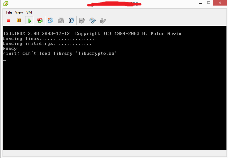

im trying to install a routerOS 6.20 from iso into VM, but boot from iso fail with
/init: can’t load library ‘libcrypto.so’
and VM rebooting

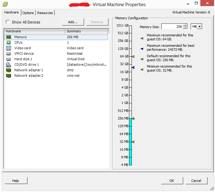

VM config:
RAM 256
1 CPU
2 nic e1000
hdd IDE 1GB
cdrom IDE
OS Other linux 32bit
i have a 6.2 on another server and its installed and working fine. Have anyone any ideas to resolve this?
5.26 installed and working fine, but 6.20 wont
and VM rebooting
