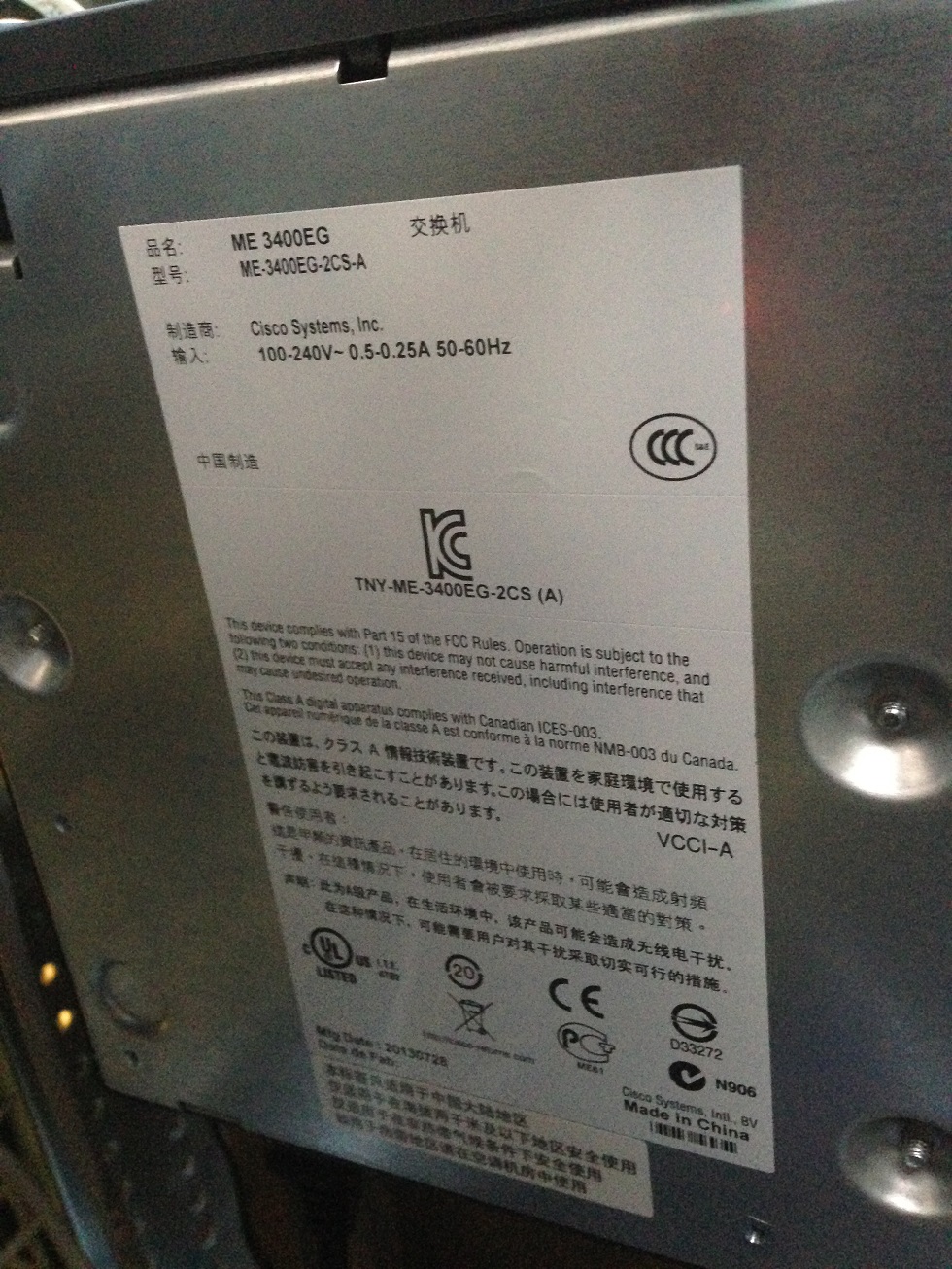

MattC86, please tell us exactly the full part number of the CISCO ME 3400 device. We will check if we could try to get it locally and check where could be the problem.
Hi Uldis
I believe it’s a ME 3400EG-2CS-A
