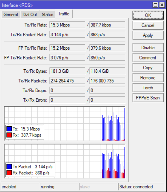

After update RouterOS to 6.44,pppoe client is having a tx drops issue,it happends every 1 minute and drops 2 packets regulary.
When I down grade to 6.43.12 everything is ok and no tx drop issues.
So I’m wondering what is wrong with my router? Config issue or RouterOS issue?

set discover-interface-list=none
dropped packet is discovery packet
Solution is
set discover-interface-list= !dynamic
if discovery on a dynamic interface then
every pppoe interface may have Tx Drop
