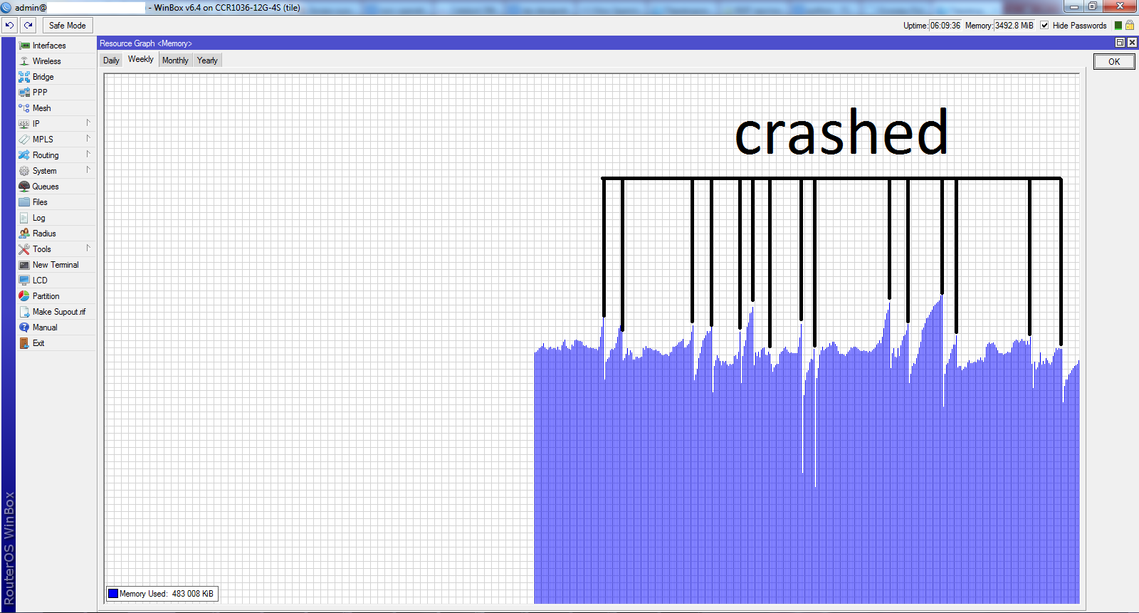

I have this problem (1700 dynamic simple queues) is added to a memory leak and crash
but the support says we do not see a problem :slight_smile:

Support emailed you 2 hours ago. The files didn’t show any crashes, do you have UPS to ensure power stability? If it’s not a power issue, you could send us remote access to monitor your device. I also see you use v6.4, since then, we have fixed some CCR crashes, so please upgrade to v6.6 first.
I also see in your graph, that traffic is going all the time. There is no indication of a crash.

Starting with version 6.0, I have a memory leak, the support was responsible for months.
I’ll even send video but I was given only one answer
Sorry for delayed reply, unfortunately we still are not able to reproduce this
memory leak.
Try to set PPTP server max-mtu and max-mru to 1450. It is the new default value
for PPTP server, it was reduced to avoid fragmentation. Perhaps it can help.
Regards,
Janis Becs
I’m having this problem on 1100AHx2, x86.
Finally, I redid the configuration and removed the simple queues (now the tree queues).
But I still occasionally drops hardware, although no longer leaks memory with trees :laughing:

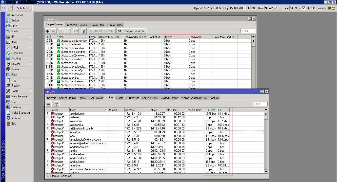

I’m also having a similar problem, the customer has the limitation in queue, however he sails with much more speed, and shows no traffic queues, everything is reset in the counters on queue, it happens using hotspot
I’m using the CCR-1016 12G ROS v6.6
You have not sorted the Queues by number (first column), so we can’t see if your first queue has traffic.
then one of the things I did was insertthe queues below
/ ip hotspot user profile
SET [find default = yes] queue-insert-before = bottom
but I managed to work around the problem temporarily excluding the queue hs- generated by the rate-limit(this blank) hotspot profile
