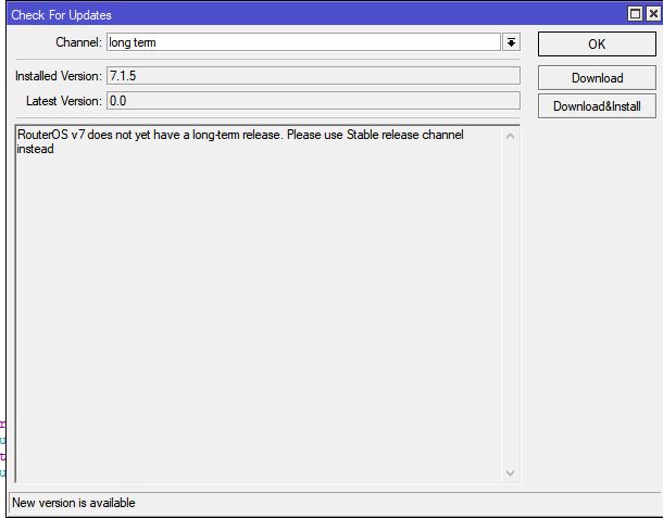

Dear all, about 6 weeks ago I moved most of my routers from 7.2.3 to 7.1.5, which was offered in the “long-term” channel. The the hope was to avoid crashed routers when updating in the (not so…) “stable” channel.
Now I get this. Can some kind soul explain what’s going on here?
That is correct, there NEVER HAS BEEN a version 7 Long Term software/firmware offering yet.

Well, 7.1.5 was definitely offered in the long-term channel in early June. This is why I installed it.
It was offered as long-term to make people with v7-only devices slightly less irritated. I’m sure some slightly more recent version (e.g. 7.2.3) will appear as long-term soon enough.
The fact that it hasnt been there for a long time indicates it wasnt really, and some overzealous webmaster probably got his peepee slapped no doubt for posting it.
OK, so versions showing up in the long-term channel might or might not be long-term. My bad, I guess I should have known this…

Well, that url still gives version 7.1.5 for long-term:
https://upgrade.mikrotik.com/routeros/LATEST.7fix
Thought this is the url that RouterOS uses to check… Looks like it is not.
Does anybody know the correct url?

It’s simple. RouterOS has different channels, where long-term should be the most stable of all. So if 7.1.5 was there for a while (which many would agree was premature) and someone installed it, it may be a little disappointing to see that MikroTik changed their mind and now there’s really no long-term version yet. First part of it is “so what the hell is the thing I installed?!”. Second worry can be about updates. Those are generally good, especially security ones you’d expect in long-term branch. So someone might fear that if there’s bug in this “fake” long-term version, there won’t be fix for it. But I wouldn’t worry about that too much. There’s not that many security bugs in the first place. And if some really bad one came up, MikroTik can easily release something in long-term channel. It’s not like there’s some rigorous process for that, they basically promote some version to long-term from time to time, after the base version wasn’t too disastrous for a while.
And eventually there will be “real” long-term version to replace 7.1.5.
