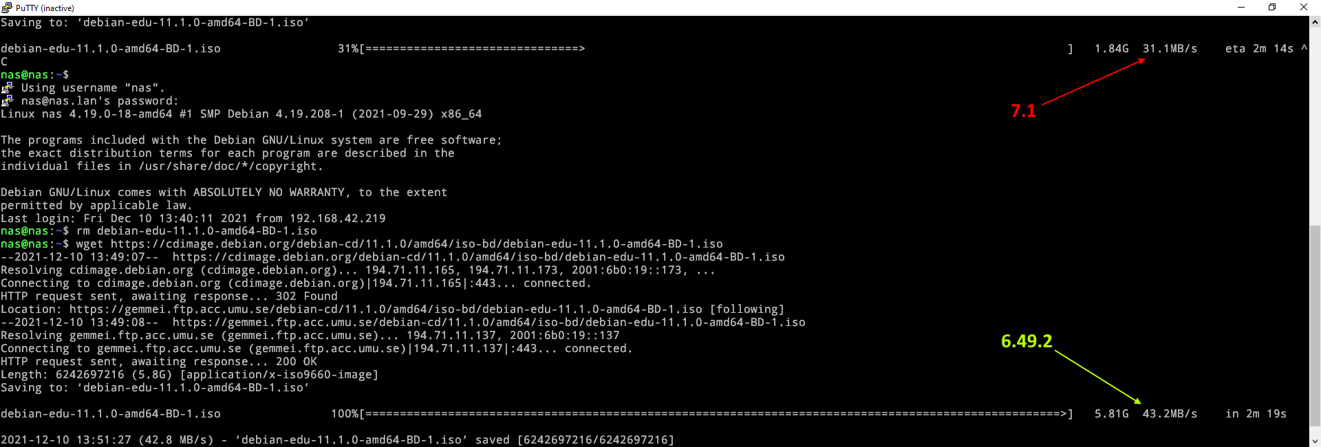

Here is “Real life scenario”: I flashed 7.1 again, made file download and then flashed back 6.49.2 with settings purge (no any cache) and tried again - and result was higher again.
Do you still believe in “routing cache hit”? Or it’s simple lack of optimization?

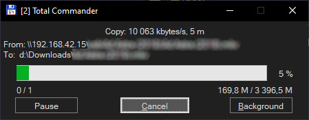

L2TP + IPSec
I was downloading file at office from home.
I’m satisfied :slight_smile:
