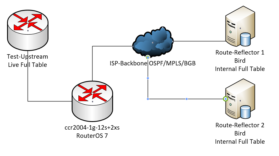

I’m testing RouterOS 7 on CCR2004 for our backbone. We are currently running some of our peering routers with RouterOS 6 on CCR2004 and are not really happy. Never get more than 300Mbit throughput when handling traffic that has to go to the outside while internal traffic (OSPF routes only) reaches near wirespeed. If it reaches that amount of traffic, packet loss is happening. Thought it might have something to do with bad BGP implemantation in RouteOS 6. So we decided to try v7 in a test setup.
We put a CCR2004 with RouterOS 7.2 at the edge of our network and integrated it in our OSPF/MPLS network. Which worked fine so far. After that we decided to build BGP sessions towards our route reflectors and one of our upstream providers. In this first test we do not announce any prefixes to upstream and route reflectors (output filters filter all prefixes). So the router does not attract any traffic.
