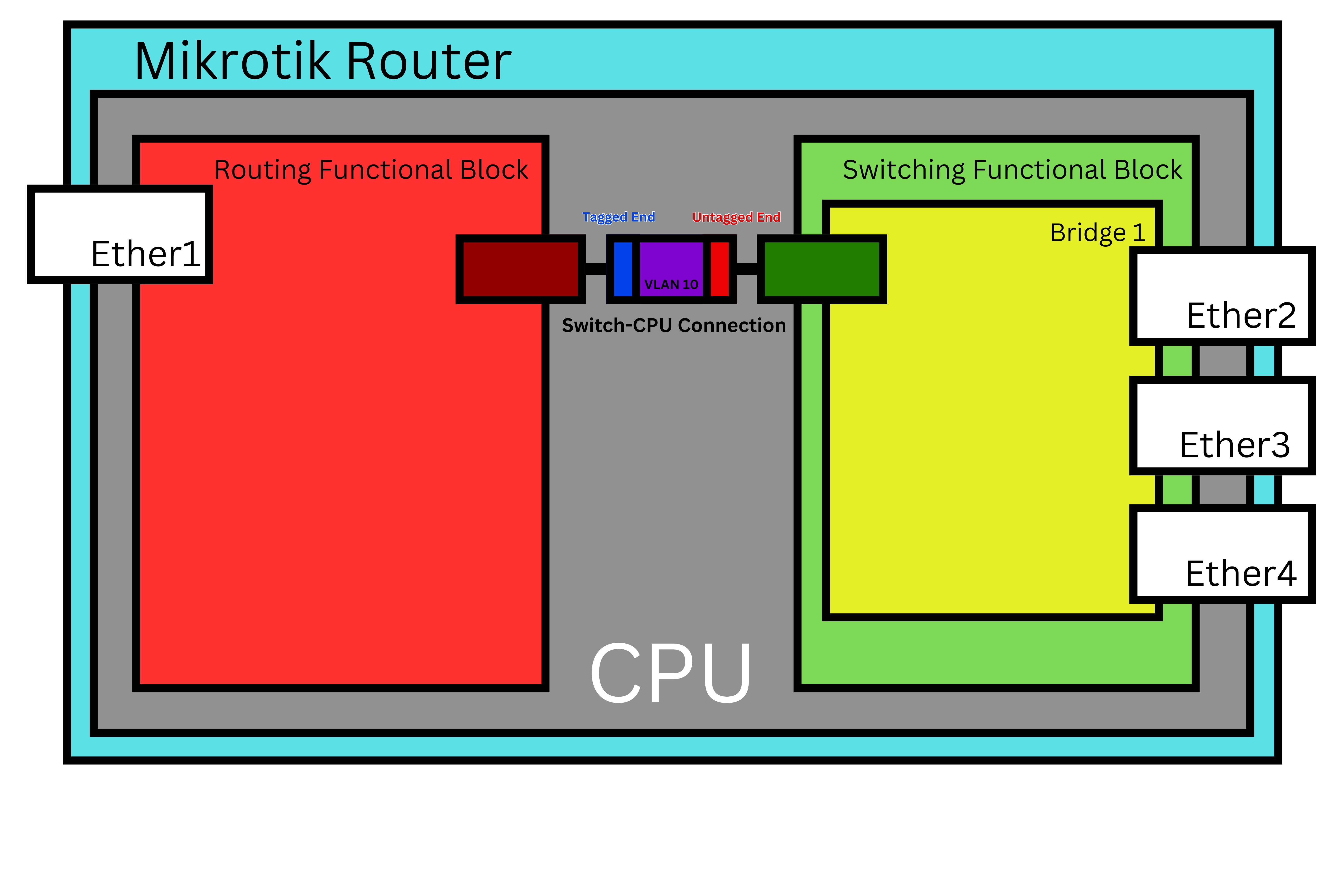

/interface bridge add name=bridge1
/interface bridge port add bridge=bridge1 interface=ether2
/interface bridge port add bridge=bridge1 interface=ether3
/interface bridge port add bridge=bridge1 interface=ether4
/interface vlan add vlan-id=10 interface=bridge1
  1. And after I issued these command it should look like the image below?(excluding switch chip because I still didn’t understand that yet)
  2. I drew the bridge as another seperate “entity” running inside the switch functional block because I think that the switch functional block is always there and is only used when the bridge is created. Is this correct?
In the context of bridge nyszeries explanation forget about switch chip (the real, piece of hardware). In this context, there’s only switching functional block, executed by CPU.
Where actual switch chip gets into the picture is L2 HW offload. But this happens transparently to the configuration (and philosophy), explained by @sindy, so it doesn’t change how all functions of bridge are put together.
I see, thank you for answering
