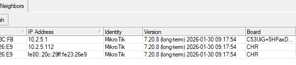

Should have responded like this (This is another working Mikrotik in my home)
18:45:50.048525 IP6 (flowlabel 0x933c3, hlim 1, next-header UDP (17) payload length: 166) fe80::20c:29ff:fe23:26e9.5678 > ff02::1.5678: [udp sum ok] UDP, length 158
` 3...............)..#&........................a..........)#&.....MikroTik...&7.20.8 (long-term) 2026-01-30 09:17:54....MikroTik.
..........aaMBNimJXSJ....CHR...................)..#&.....ether1....
..p.....

MNDP IPv4 :white_check_mark: Working Packets from 10.2.5.1 & 192.168.155.1 received
MNDP TX IPv6 :white_check_mark: Working Router sending to ff02::1
MNDP RX IPv6 :cross_mark: BROKEN Router receives but doesn't respond
ICMPv6 IPv6 :white_check_mark: Working Ping6, Router Advertisements all work
General IPv6 IPv6 :white_check_mark: Working Full connectivity confirmed
