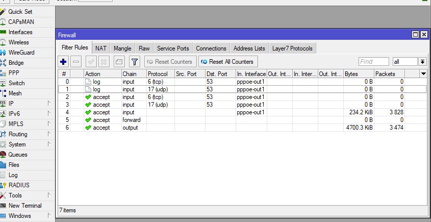

I put the rules at the top:
add action=log chain=input dst-port=53 in-interface=pppoe-out1 log-prefix=\
    "PORT 53 TCP HIT" protocol=tcp
    "PORT 53 UDP HIT" protocol=udp
add action=accept chain=input dst-port=53 in-interface=pppoe-out1 log=yes \
    log-prefix=-mydns protocol=tcp
    log-prefix=-mydns protocol=udp
add action=accept chain=input in-interface=pppoe-out1
add action=accept chain=forward
add action=accept chain=output
Connections to port 53 always work on the LAN. In fact if I setup a NAT port forward, if the outside ports are 52 or 54 and inside port is 53, connection always works. Yes device is not secured and hackable. This config is only for demonstrating the problem with port 53. I’m not posting my production config. As for the ISP not being transparent ? I’ve spoken with the network engineer who built the network and have been advised at lengths that there is no filtering. Further to that, I was given and IP address of another user in my CIDR block that does have a working DNS server using port 53 on the same network I’m on at my ISP. DIG / nslookup queries to that IP still work as of this posting.
Here’s a winbox showing no packets received for port 53:
People would open up port 53 for the purpose of running an Authoritative DNS server. ( https://en.wikipedia.org/wiki/Name_server ) This is my purpose as I’ve stated before. Your fix of using the default mikrotik configuration that comes with the router also doesn’t work. I’ve omitted it for the sake of simplicity here, that’s why my config has no firewall rules. Also, everything is working, its just port 53 TCP / UDP out of all the 65535 ports that is not working for me.
