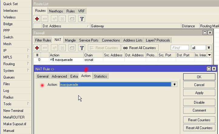

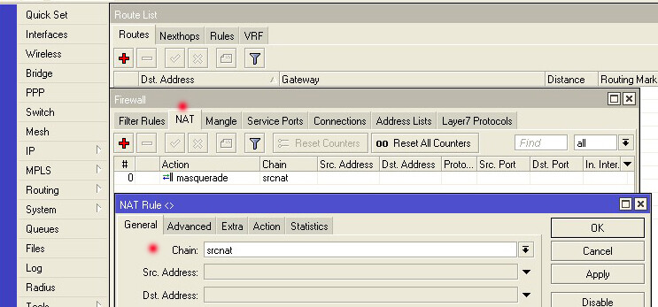

have you set firewall nat rule
scrnat = masquerade

http://www.imageupload.org/en/file/240512/mikrotik-jpg.jpg.html
not working., in Nat., I also try put " out " ether1 - 2,bridge, etc.
