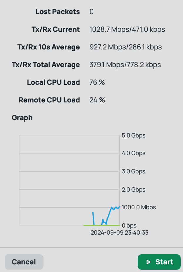

Great! I tried this out and the result is truly surprising! TX (i.e. upload) is around 700Mbps but RX (i.e., download) is just half of it. See: https://snipboard.io/ae5ERy.jpg

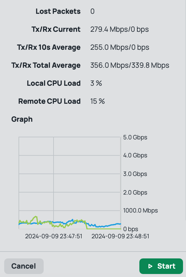

Ok I tried it out now with 1xP-10 and 1xP-unlimited.
Again, the result is truly incredible.
  • The first screenshot shows the demo license. RX is just 1Mbit or so (as expected) but TX reaches 1Gbit.
  • Now the second one shows with the bandwidth server upgraded to P-unlimited. Now RX+TX are again limited to 500Mbit each.

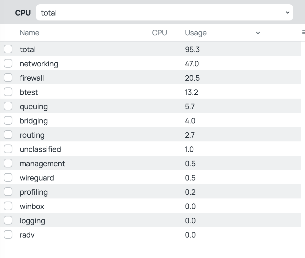

With BTest your CPU is under 100% load, that may probably cause issues. Can you use Tools->Profile to see if your router handles your loads maybe?
Thank you @kleshki! See here:
Indeed, the CPU is under heavy load. It fluctuates but above is roughly the situation during the bandwidth test. Have of the CPU goes into “networking” (which is not very specific to me).

Then I just get 10% networking, 10% BTest, 10% firewall (roughly).
And speeds 3.1Gbps / 6.7Gbps (Rx/Tx)
No, in first post you stated that you run speedtest from container. Can you do the same but now watch perfmon
Same. CPU of “networking” goes to 40%
