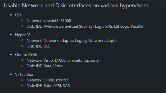

I also tried enabling promiscuous mode for the NICs in PVE, but that didn’t help. Additionally, I came across some posts mentioning compatibility issues between CHR and the I226-V NICs in virtualized environments. However, no solutions were provided—only recommendations to switch to a non-virtualized installation.

Think that CHR is mostly directed for virtualized interfaces and even passthroughed card seems to work it could be a coincidence.
