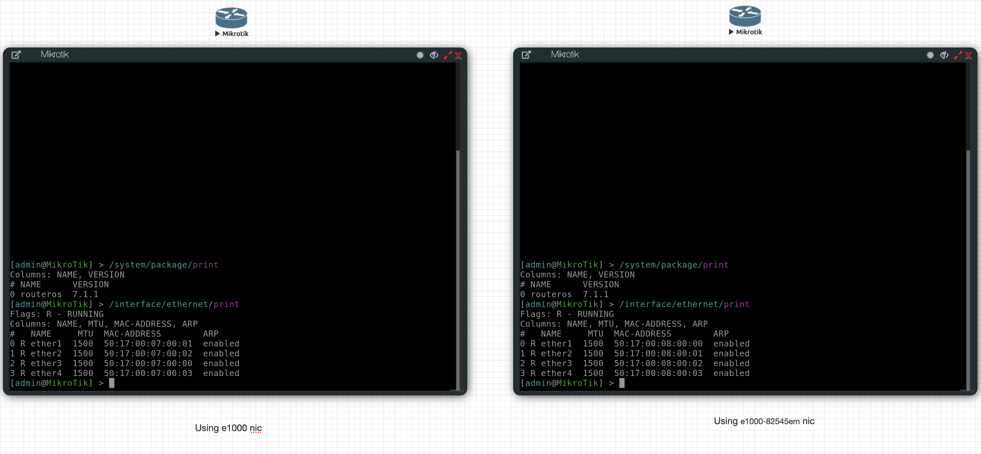

EVE-NG changed default templates for Mikrotik RouterOS as suggested.
Next release will use the e1000-82545em nic.
In the meantime, any user could just use from /opt/unetlab/html/templates, the command:
git pull
Below the behavior in both cases…
