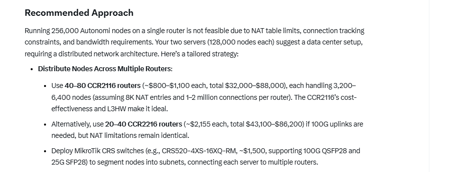

I have 2.5gb up/down but its plenty the speed barely affected at all,(I ran a speed test multiple times) I’ve been asking grok and it’s saying that the ccr2116 is getting overloading with millions of connections from the nodes and it is maxxed out. Grok was suggesting I run opnsense on one of my servers bc the ccr2116 isn’t capable of handling all the nodes I have it suggested I needed like 10 2116’s for the amount of nodes I’m running

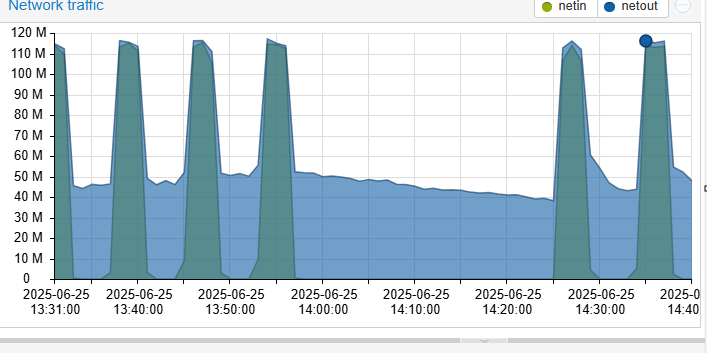

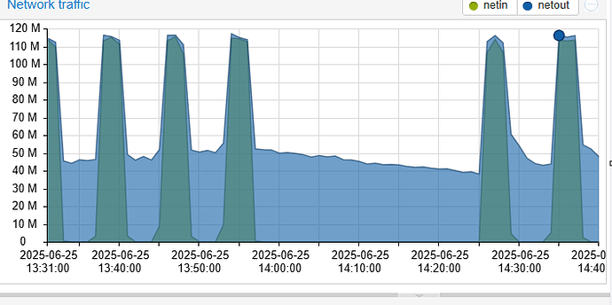

This is my network traffic, well above a ccr2116’s limit which I think is a couple million right?
120M what? Packets per second? Bits per second? Bytes per second?
it’s megabytes I guess. But I was looking at the connections as well in the firewall>connections tab and that is what grok was telling me was over the limit this is what grok told me:
