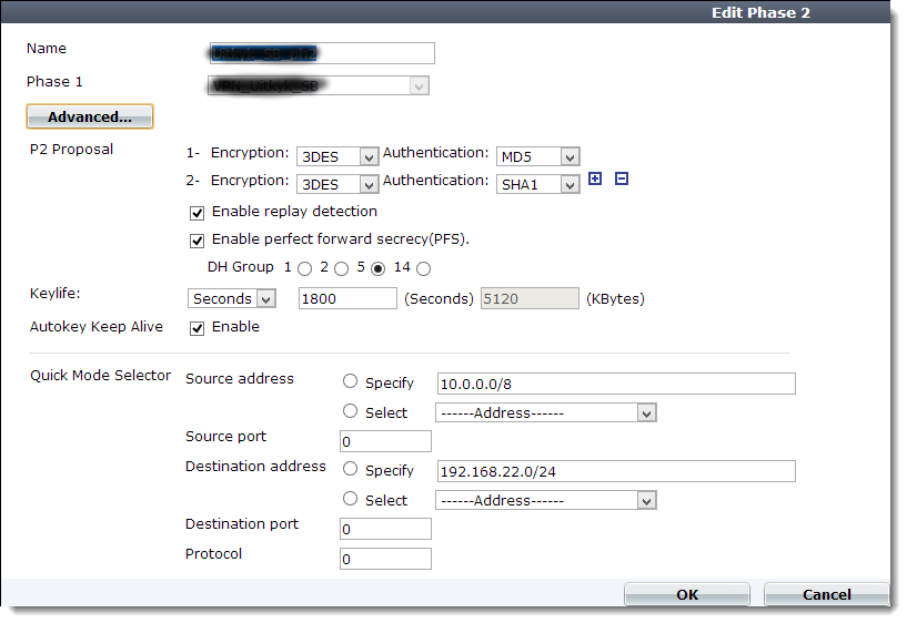

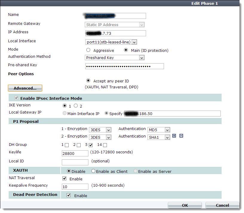

I have pasted their config for your perusal. I have also started a bounty on Server Fault because we are about to loose this client.
http://serverfault.com/questions/559820/mikrotik-ipsec-client-fortigate-received-esp-packet-with-unknown-spi
First thing to note, phase1 lifetime settings do not match. You have 1day while they have 8 hours (28800 second). Make them match. Also make sure everything else matches as well. Set proposal check setting to strict, it will ensure everything matches (otherwise tunnel will stop working).
Thank you. We have tried setting it to 8 hours as well but at this point of the frustration the entry was the MikroTik default of 24 hours.

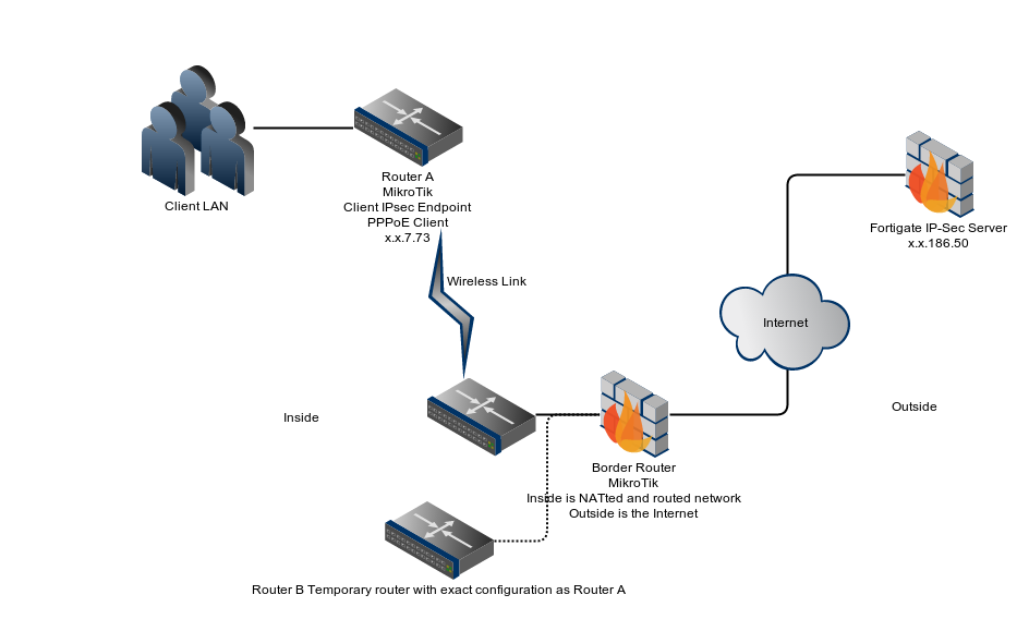

So here is the solution, which again, is completely random and does not make sense. I have attached another diagram inline to show you what happened.
**We fixed it by:
  1. Turning off PPPoE at client.
  2. Installing completely new router (Router B) and tested at Border. It worked at Border.
  3. Switching off new router B at border.
    AND THEN, WITHOUT MAKING A SINGLE CHANGE, the client’s end-point Router A started working. So just adding a duplicate router at the border and taking this router offline again made the original router work.**
So add this fix to the list of things we’ve done:
  1. Reboot. That worked once.
  2. Create new tunnel with new IP. That worked once but only once. After changing IP back client endpoint came live again.
  3. Change time servers.
  4. Fiddle with every possible setting.
  5. Wait. Once, after a day, it just came right. This time, even after days, nothing came right.
So I postulate that there is an incompatibility on either Fortigate or MikroTik side which only happens at very random situations. The only things we haven’t been able to try is upgrade firmware on Fortigate. Maybe there is hidden corrupt configuration value or timing issue invisible to configurer.
I further speculate that the issue is caused by random timing issues causing SPI mismatch. That justs happens randomly. I’ll add to this post when it happens again.
