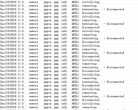

  1. RouterOS creates pppoe-client to dial ISP successfully and fails to dial again if disconnected, regardless of device reboot or cat reboot.
  2. The only solution at present is to reconfigure the dial successfully after resetting the RouterOS device.
Or after resetting the RouterOS device, importing the previous backup file connection succeeded
This problem has been bothering me for a long time, and it affects the use of it.
RouterOS version 6.42.10 or upgrade to 6.43.7 has this problem
There are also different RouterOS devices that all have this problem and I don’t know how to solve it.
Ask you how to solve this problem without resetting the RouterOS device to redial
Logs on RouterOS are shown as follows:
Attachment pictures
Probably related to protocol compatibility
Some server protocols may be incompatible
When disconnecting,ros perhaps no corresponding packet was sent. (like PADT)
