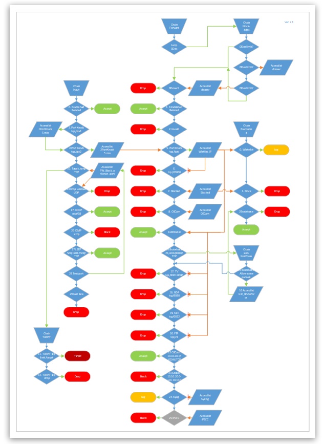

PS I do have a drawing on how my rules are setup to help me out.
@tangent Thanks for your thoughts. That is an interesting idea, albeit pretty involved to set up and test.
@Jotne Thanks for your flowchart. Something like that would be very helpful, especially if it’s kept up to date. I get the idea of logging statements throughout, but you’re still having to poke around to figure it out. What I’m asking for would not require adding any (log) rules and would work across all chains and areas (Filter, NAT, Mangle). I still see something like I’m asking for as being very useful. In addition to being very helpful at troubleshooting, it would also be useful in training and learning.
