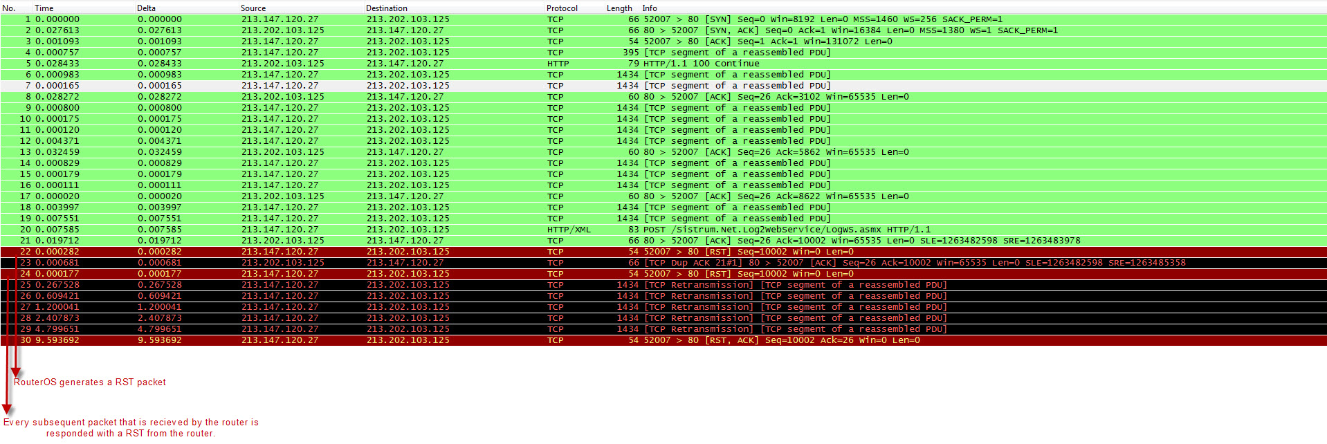

I work in a telecom NOC and we had a strange problem with the RouterOS. One of our customers was using a server in the local LAN to send data to a remote server using HTTP POST. During this TCP connection RouterOS would generate and send a RST bit to the server all on its own for no apparent reason even tho the router was never communicating with the server but eather just forwarding and NAT-ing traffic. We were sniffing data on the LAN and on the uplink and were noticing this strange behaviour.
The router was configured with NAT and the local LAN server was NAT-ed over a bridge interface with a public IP address 213.147.120.27. In the sniff you can distinctly see that after recieving a packet numbered 21 that the router generates packet 22 which is a RST packet. Every subsequent packet that is recieved by the router destined to the loopback public ip from the remonte servers ip 213.202.103.125 is responed to by the routerOS with a RST packet. This stops the remote server connection and it stops transmitting which causes the whole connection to be dropped which can be seen in packets 25-30 where the local server starts sending retransmitions and then gives up and sends a RST ACK. This keeps happening constatly and normal operation of the communication is not possible.
The RST packet that is seen in packet 22 is never seen on the local lan and the local LAN server never generates it, it is generated on the router.

I am sure that the rotuer was generating these RST packet because we were sniffing traffic on the uplink interface (link after packets leave the router to the internet) and also at the same time we were sniffing taffic on the device which was communicating with the server on the local LAN. We neever saw this device generating those RST packets but we were seeing them on the uplink.
We were sniffing using wire taps not on the mikrotik sniff tool.
