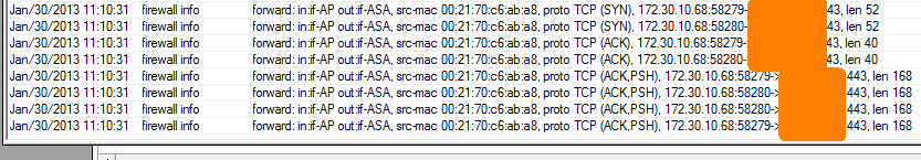

1.png shows the logs from mikrotik
3.png shows that the packets received are invalid (have invalid CRC)
By inserting an iptables rules blocking these TCP-RST packets, with destination the specific IP and port 443, the connection with OWA works fine!
Although Mikrotik detects the packets with invalid “CRC” it does accept them. How this happens ?
Also, why MT sends an RST-TCP packet if packets aren’t really invalid ?
