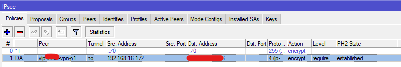

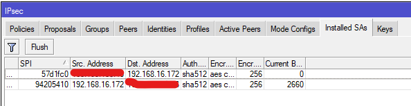

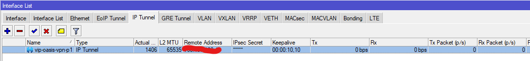

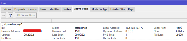

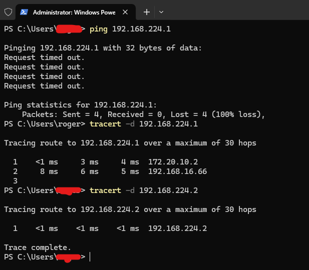

I am trying to configure tunnel interface on Mikrotik. I recently acquired a CHR license. I am using it on Hyper-V. I was able to establish the VPN tunnel with IPIP Interface, SonicWALL shows the tunnel was successfully established, but traffic does not flow through IPIP Interface.

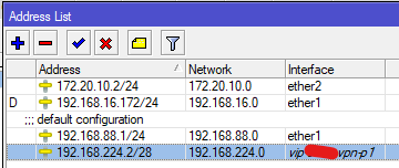

I have noticed that even with IPIP interface state UP, Mikrotik shows it as down (italic) at “Address List” screen.

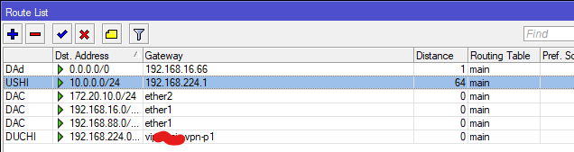

I successfully ping IP address assigned to IPIP VPN Tunnel. I see that traffic is correctly routed to IPIP VPN interface. But, traffic to remote VPN subnets are routed to internet.
Could someone try to help me understanding what is going on with Mikrotik IPIP IPSec VPN Tunnel Interface?
